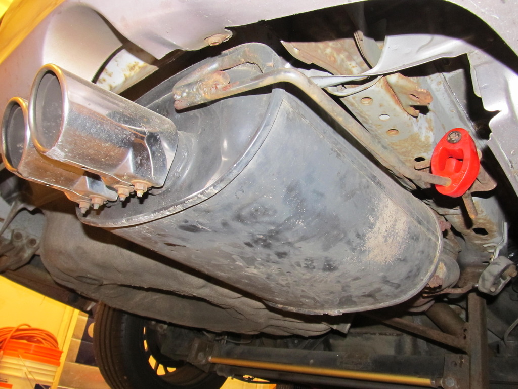

Time for a super small update!
The G35 sedan muffler has always banged around when I go over large bumps, but I had gotten used to it. Now that I'm relearning the car after not having driven it last year, I'm noticing certain things, like how much the muffler banging on things bugs me. Time to take a look and see what's going on.
Well, a sagging hanger probably isn't helping...
Attachment 11625
I had a spare poly one lying around so I threw it on...

Woo, red! Thankfully, you can't see it unless you're under the car.
While I had the hanger off, I started playing with the muffler to see where it was hitting, and it was towards the back on top. I wanted to use my angle grinder on it, but that would have required taking off the cat-back, which I was in no mood to do, so it was up to the Dremel to get things done. Naturally, this took much longer than the angle grinder with a cutout wheel would have, but it worked.
I marked off the area I wanted to cut out:
And got to work:
After that, I could get the muffler to hit, but it was much harder. After driving around for a few days, I did hear it bang a few times, but not nearly as often as before. I think I'm going to trim some more out to see if I can completely eliminate the banging. More updates coming!

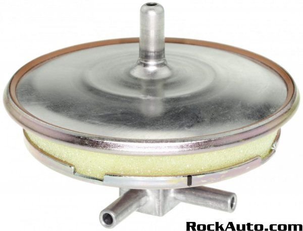

Hey guys, I could use some help getting rid of a P0400 EGR code! I've read all the threads on the topic, and did everything I could think to do, but the code still hasn't cleared itself, and my emissions due date is rapidly approaching, and I need some help! Unfortunately, I can't post pics right now of all the work I've done so far, but here's the run down:
-I have my EGR blocked off so it can't dump back into the IM. From what I can tell, my EGR system is all from a 4th gen, but it's on my 3.5 motor.
-I cleaned out my semi-clogged EGR tube. It wasn't 100% blocked, maybe 75%.
-I tested the resistance of the EGR temp sensor with a pot of boiling water and the resistance was correct.
-I tested the resistance of the EGR control valve solenoid and it is good. I cleaned the EGR control valve solenoid to allow the metal cap inside to move freely and now it does. Before, it was semi-stuck.
-I replaced all EGR gaskets.
-All EGR hoses are intact and attached.
-I also installed a new OEM Nissan gas cap since one person said that solved their problem.
The only thing I can't test (or don't know how to test) is the EGR vacuum solenoid that sits on top of the EGR valve.
Am I missing anything here? If my EGR tube isn't clogged, the temp sensor is good, the control solenoid is good, what else is there?
