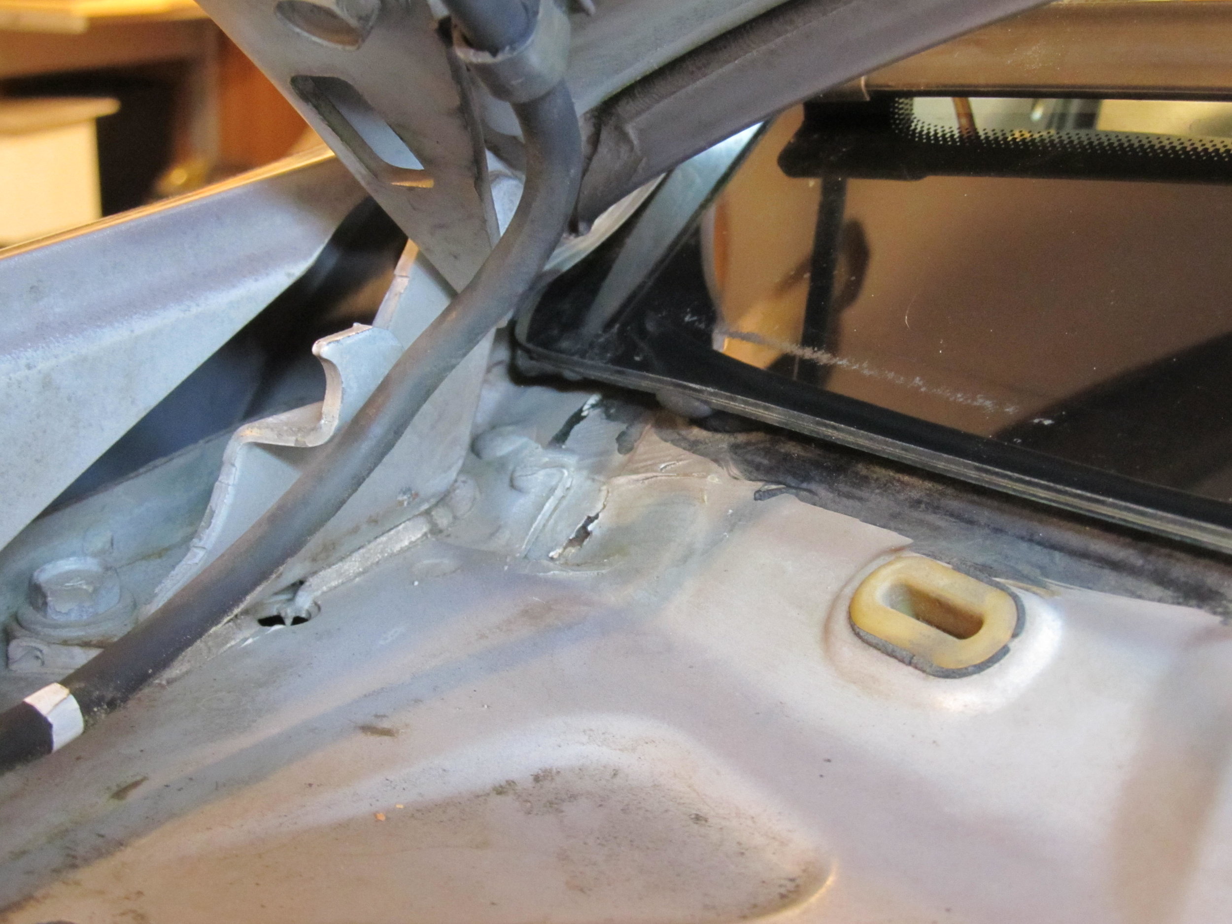

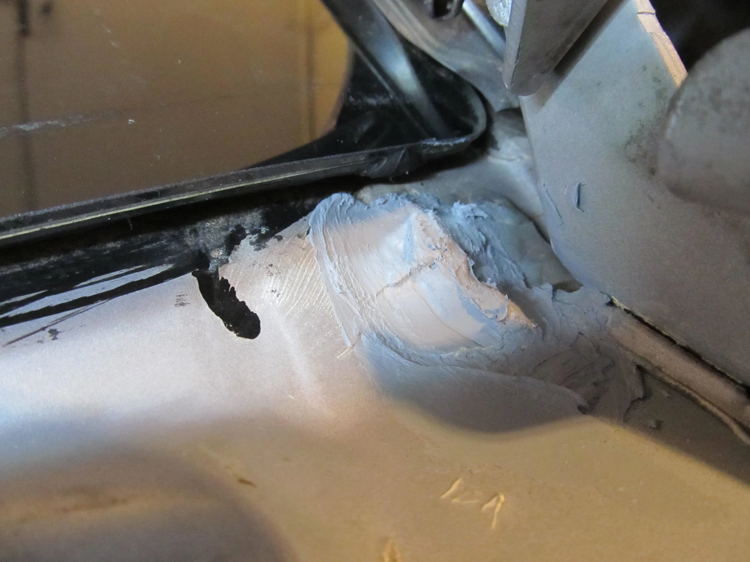

I had some more time to try and track down the source of the water leak, and I think I found it!
I started by removing the cowl cover. Or, more accurately, I struggled to remove the cowl cover.
I tried all of these tools.....
The wiper arms were seized to the knurled shaft below, and I spent about two hours fighting to get them off. With enough penetrating oil, hammer blows, and prying from below, I was eventually able to remove them. Apparently there's a tool for this, but I don't own it (yet!).
With the arms off, I could finally remove the cover and inspect the cowl area. I was concerned that the cowl area was full of debris and the drains were clogged up, but it seemed to be very clean inside:
This is the passenger side with the intake for the HVAC:
And driver's side:
The cowl cover's little gasket strip had disintegrated, so I put on a new one.
I then poured 250 mL of water down each side of the cowl and measured how much came out. Both sides were equal at just under 200 mL. I assume the residual was just stuck to the walls or something. Some dripped out afterwards too.

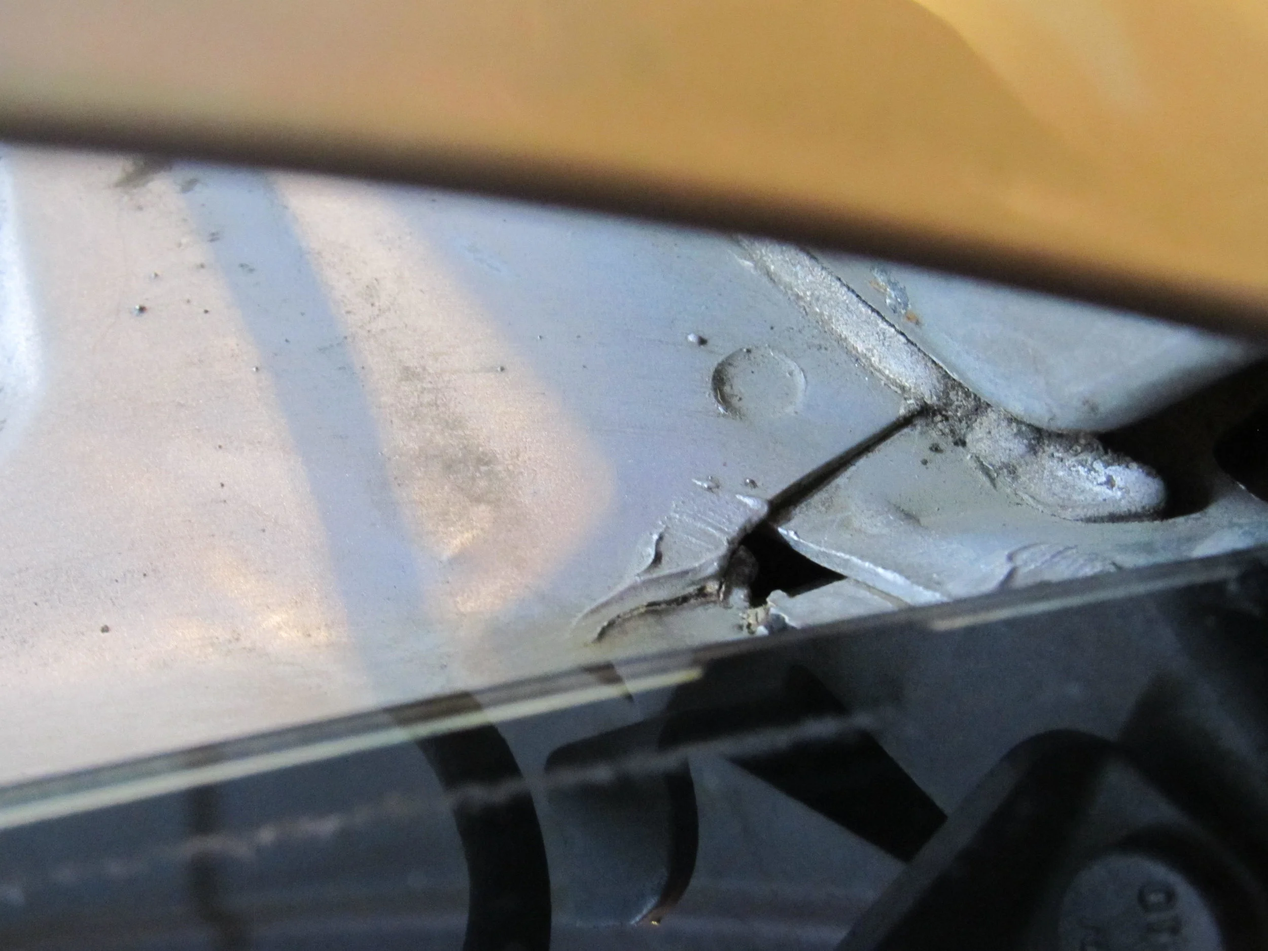

Since that didn't seem like the source of the leak, I took apart the trim around the windshield. It was very dirty in there...

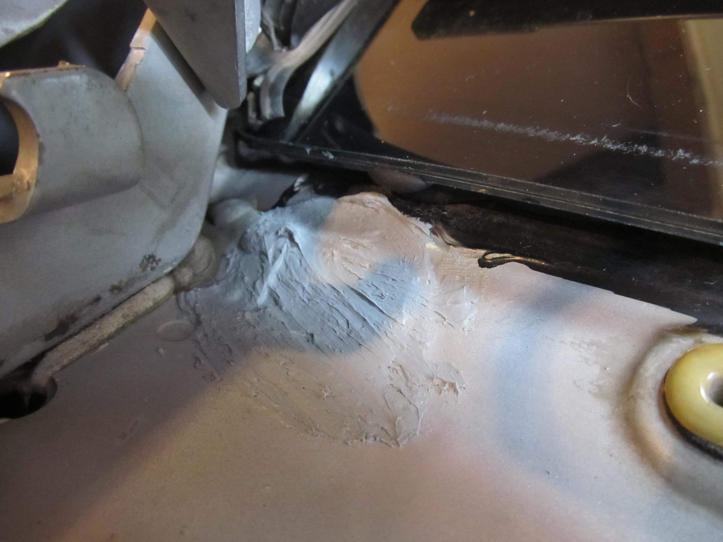

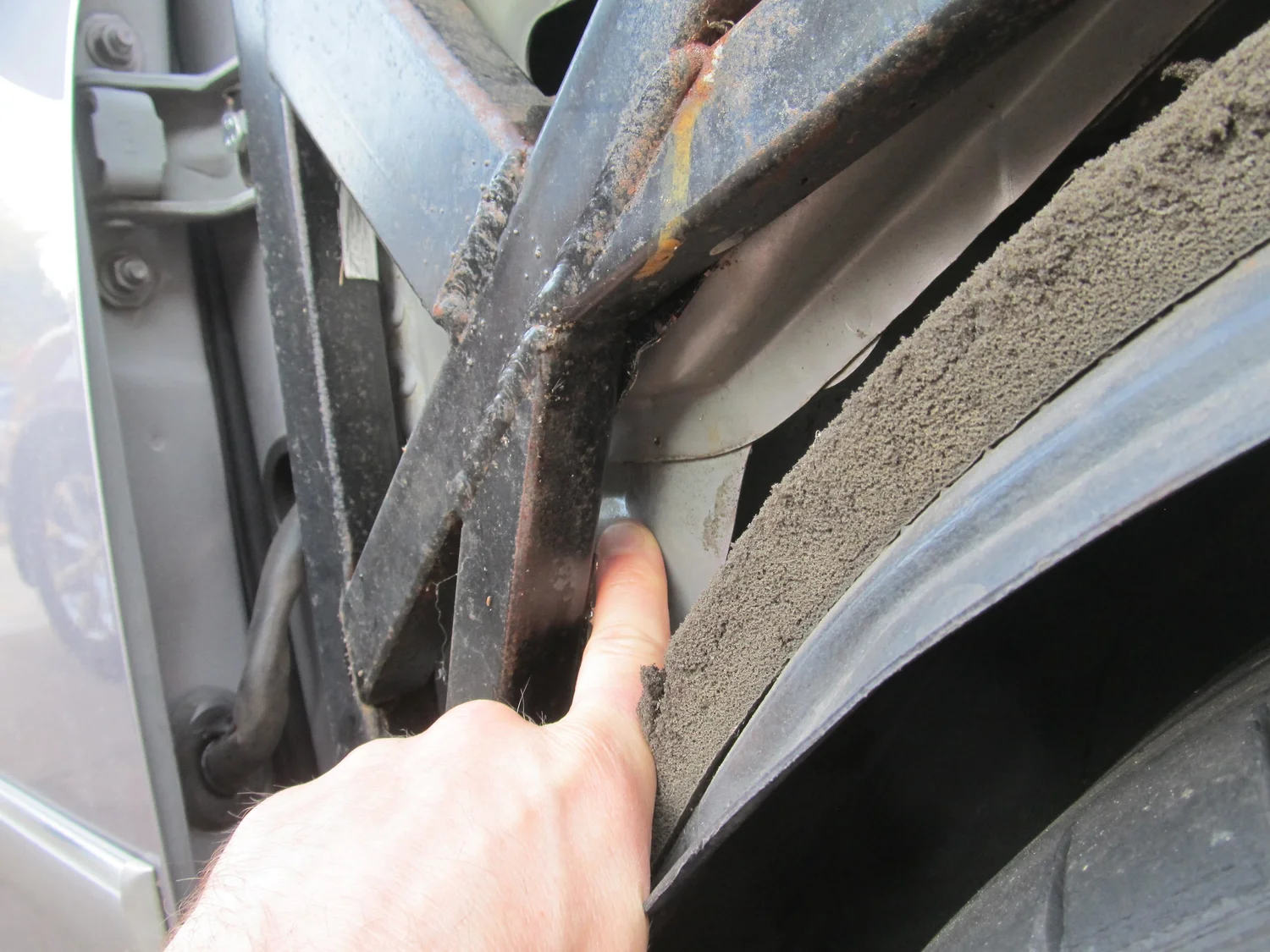

I pulled up the carpet to see if it would tell me anything. As mentioned earlier, the car is usually parked in my driveway, which is uphill. So it's possible that the water that was sitting behind the passenger seat actually came from the front of the car and flowed to the rear due to the slope. A month ago when I discovered the leak, the front was dry. But not this time! The foam under the carpet was wet up by the windshield! I pulled it back and was able to find a wet spot (at the center of the picture where the body adhesive is, behind the wires):

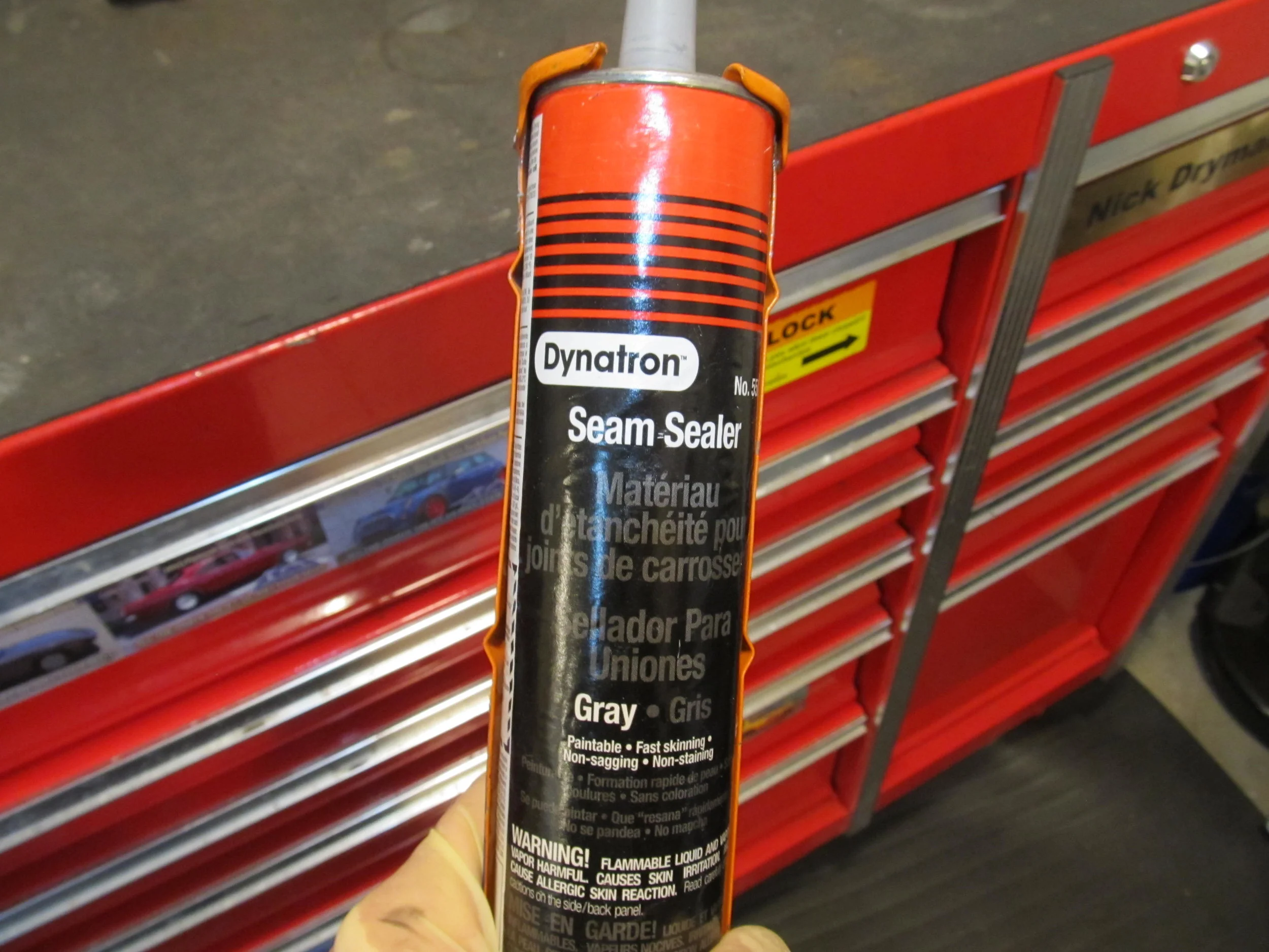

Aha, found it! Except I can't actually see where it's coming in due to all the stuff inside the dash. I had my wife pour a little water at the base of the windshield while I was inside the car, and sure enough, water started coming in. Now I must decide how to proceed. I could just smear some RTV silicone around the windshield and see if that fixes it, but I'm concerned that there could be rust around the windshield frame, and I don't want to mask the problem and let it grow. I'm considering paying the $200 to have the windshield replaced so I can inspect the frame for rust damage. What do you guys think I should do?
I had also pulled the rear molding to see what was going on back there, but didn't see anything worth investigating. So I just cleaned it up and put it back together:

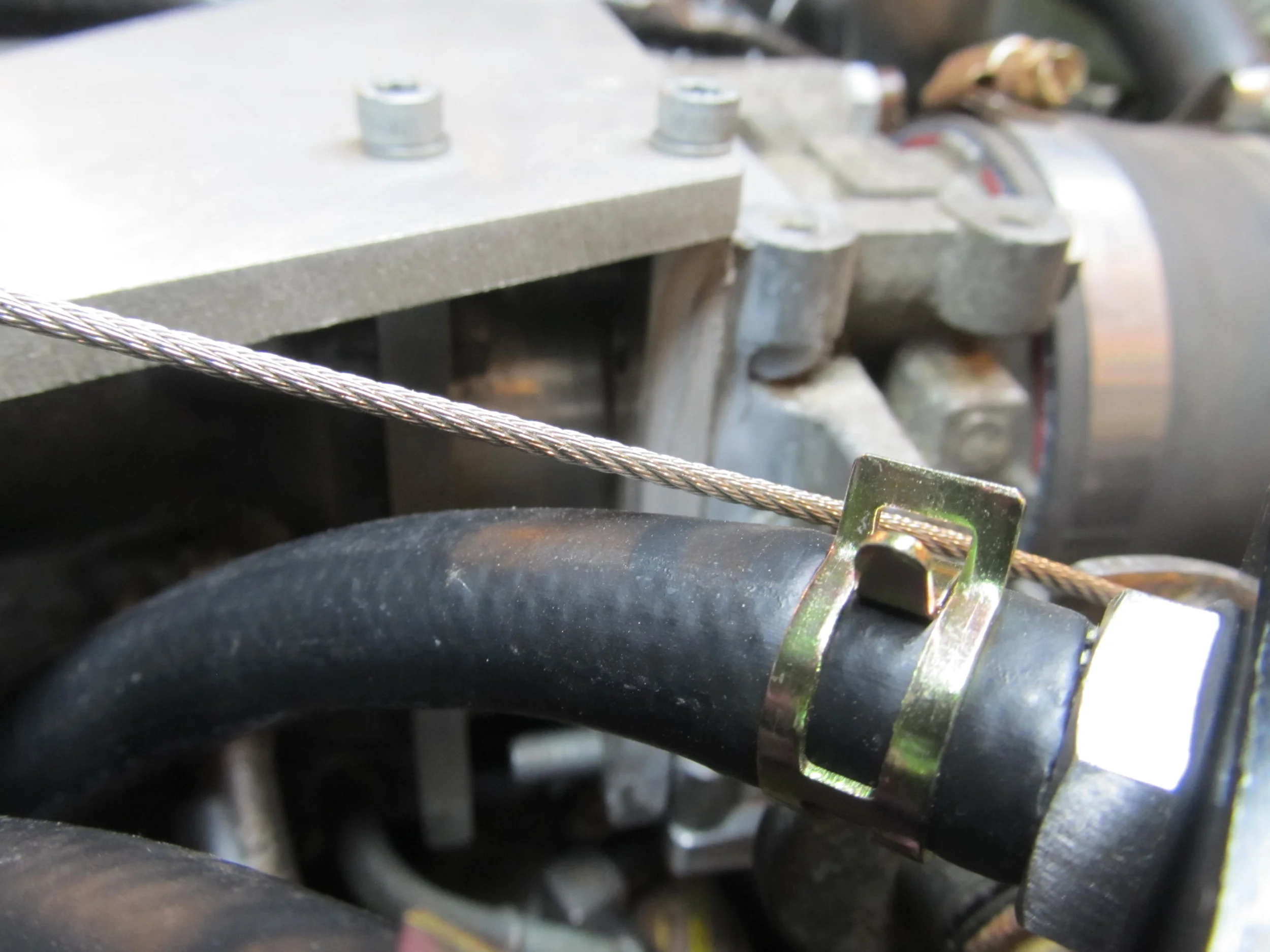

Well, you guys were right, I needed to replace my e-brake cables again!
I bought some cheap ones from RockAuto and hoped for the best. One was on clearance for $8, and the brands didn't match, but I figured they had to be better than what was in the car. The two brands certainly constructed them differently, but from what I can tell, it's an updated design over the ones I put in the car 10 years ago. This coincides with what I saw on the Nissan parts website, where it mentioned a new part had superseded the older one. It of course didn't mention what the change was, but I think I know what it is! Keep reading for details....
So the ones I installed 10 years ago didn't have much in the way of brackets attaching them to the car, so many zip ties were used:
As soon as I detached them from the caliper, I knew they had failed by the amount of water that dripped out of them:
The outer covering had split in multiple locations:
Yeah, I can see how all that water in there would freeze up and keep the cable from retracting!
So, what is this revision to the cables? Well, it looks like Nissan (and the aftermarket) decided it would be smart to put a sheath around the cable to prevent it from coming in contact with water and rusting up!
What a fine idea! As I mentioned, I bought two different brands of cables. One brand obviously wasn't as precise about putting the sheathing all the way to the end of the cable....
Still, that's a hell of a lot better than no sheathing at all!
The new cables came with actual brackets too, hooray! However, one of the brands had breaks in the outer covering, while the other had it fully sealed up for the length of the cable. That kind of bugs me, but what can I do about it now?
I sprayed a bunch of cable lube down either end to hopefully prevent it from locking up if and when it gets water inside it.
I then zip tied the rubber accordion to end of the cable to keep it from coming loose:
And with that, I put it all back together, and marveled at my cables being properly attached to the car once more:
I adjusted the handle so it clicks the recommended 10-11 times, and could immediately tell that the cables moved much more smoothly than the old ones. I'm pretty confident that this will solve my frozen e-brake problem, but I won't know for sure until another month or two goes by. Thanks for all of the help with this one, I can't believe I overlooked my cables for so long. Lesson learned: if you have problems with a frozen e-brake in the winter, detach the cables from the calipers and let them hang down. If water comes out, it's time to replace your cables!

I can't even remember why now, but at some point one of my previous "mechanics" recommended I cut one of the wires going to my hood switch, so for the past 15 years or something, the hood switch hasn't worked. In an effort to track down a parasitic drain, I figured I would hook it back up. As far as I can tell, nothing changed. This is a big deal people!
I used my new leak detector smoke machine on the I30 to see if I had any vacuum leaks. It looked like there was a small one around my intake air temp sensor in my midpipe, so I got to work resealing it. The old one had been installed with some red silicone, but apparently not enough:
So I cleaned it up, and then applied quite a bit of the black silicone, from both the outside and the inside of the pipe to ensure it's sealed up real good. I'm curious, how are other guys running their IATs?

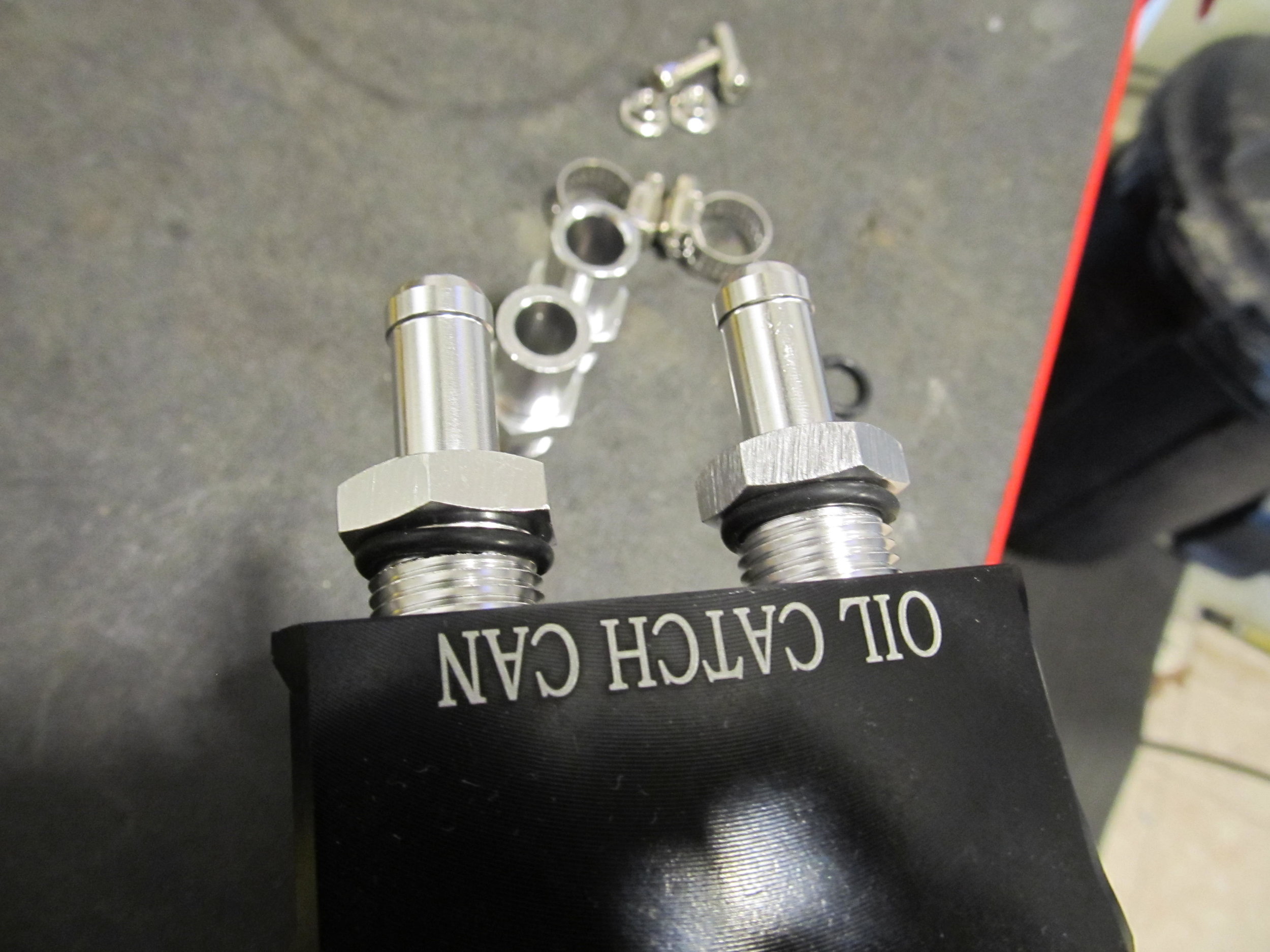

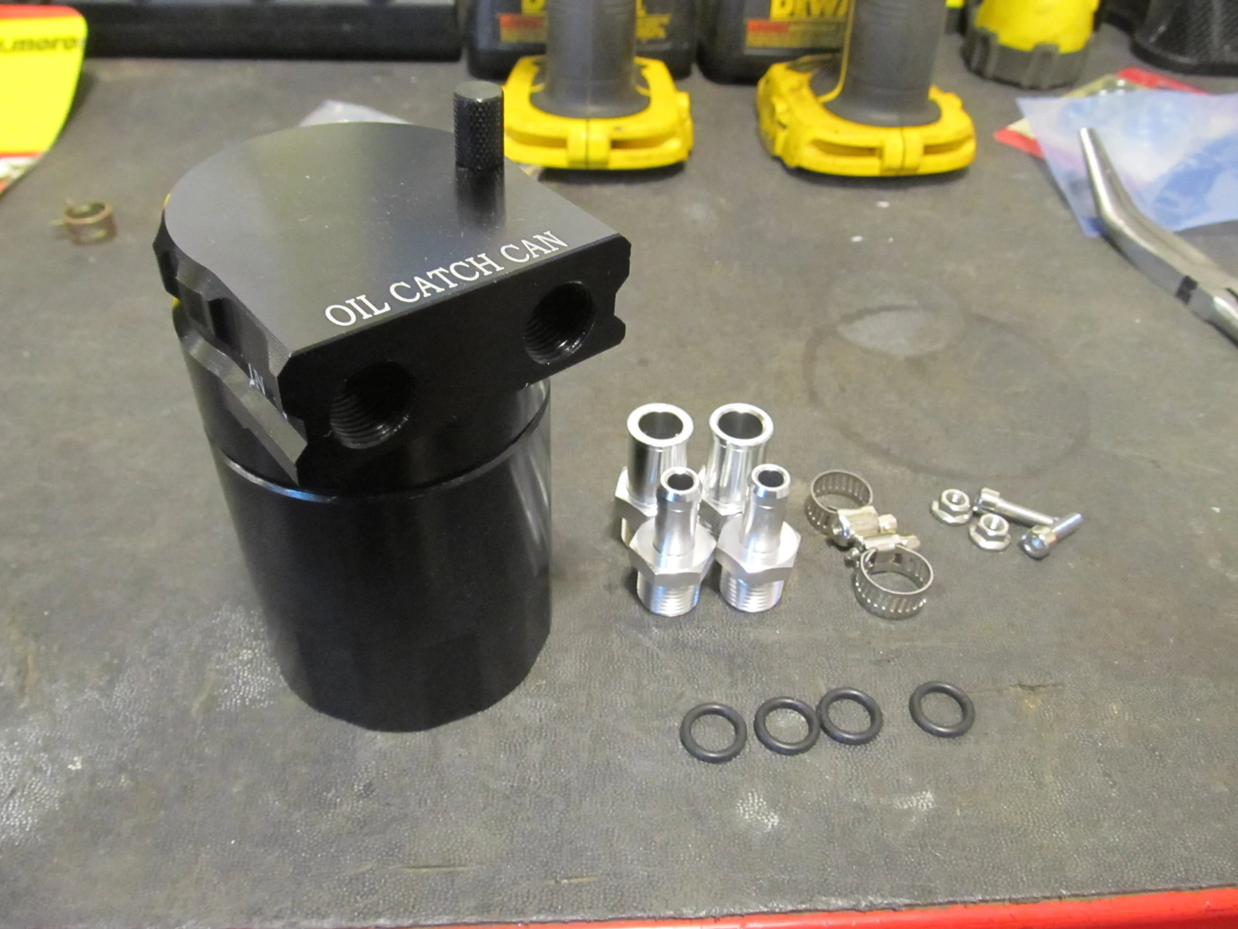

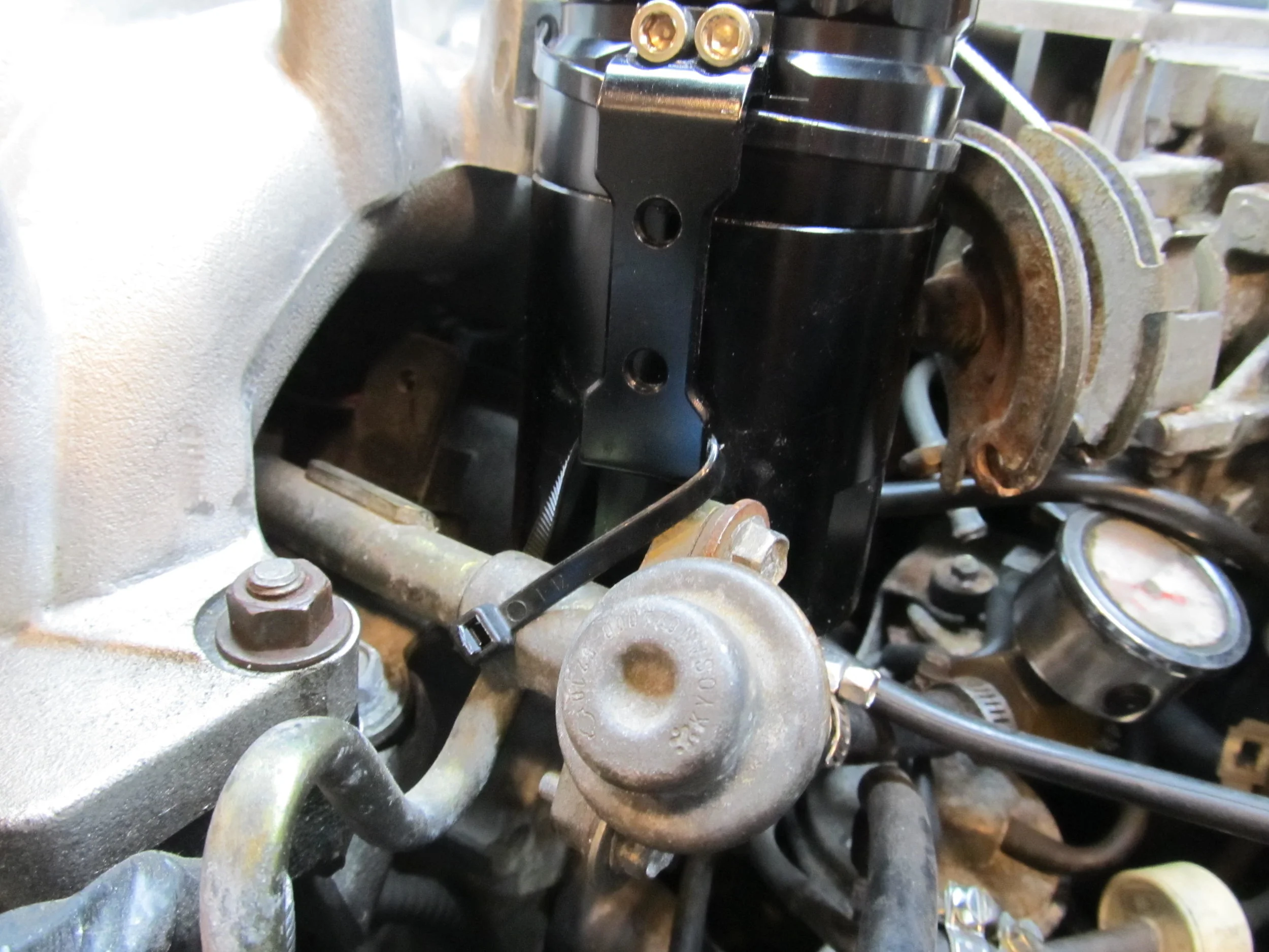

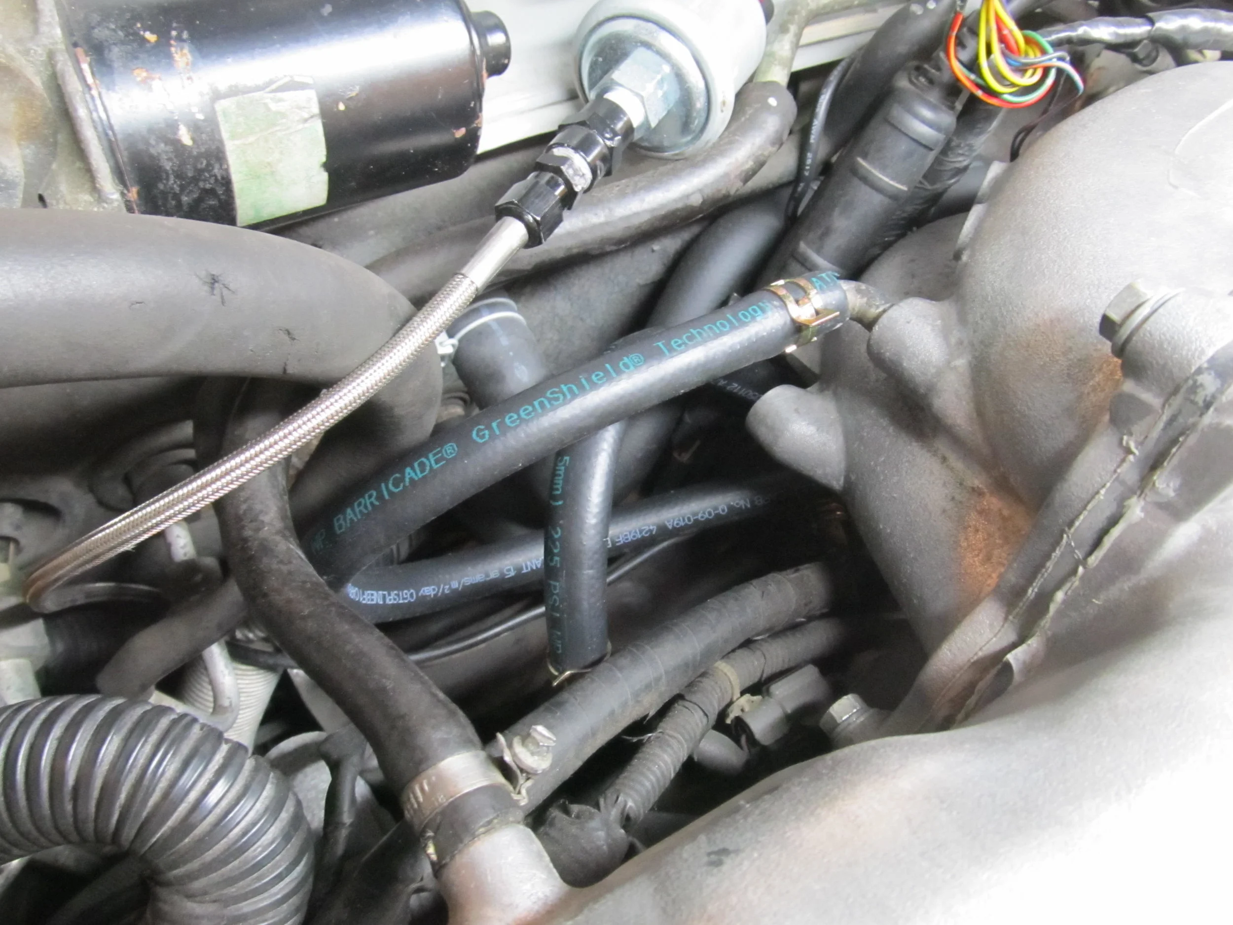

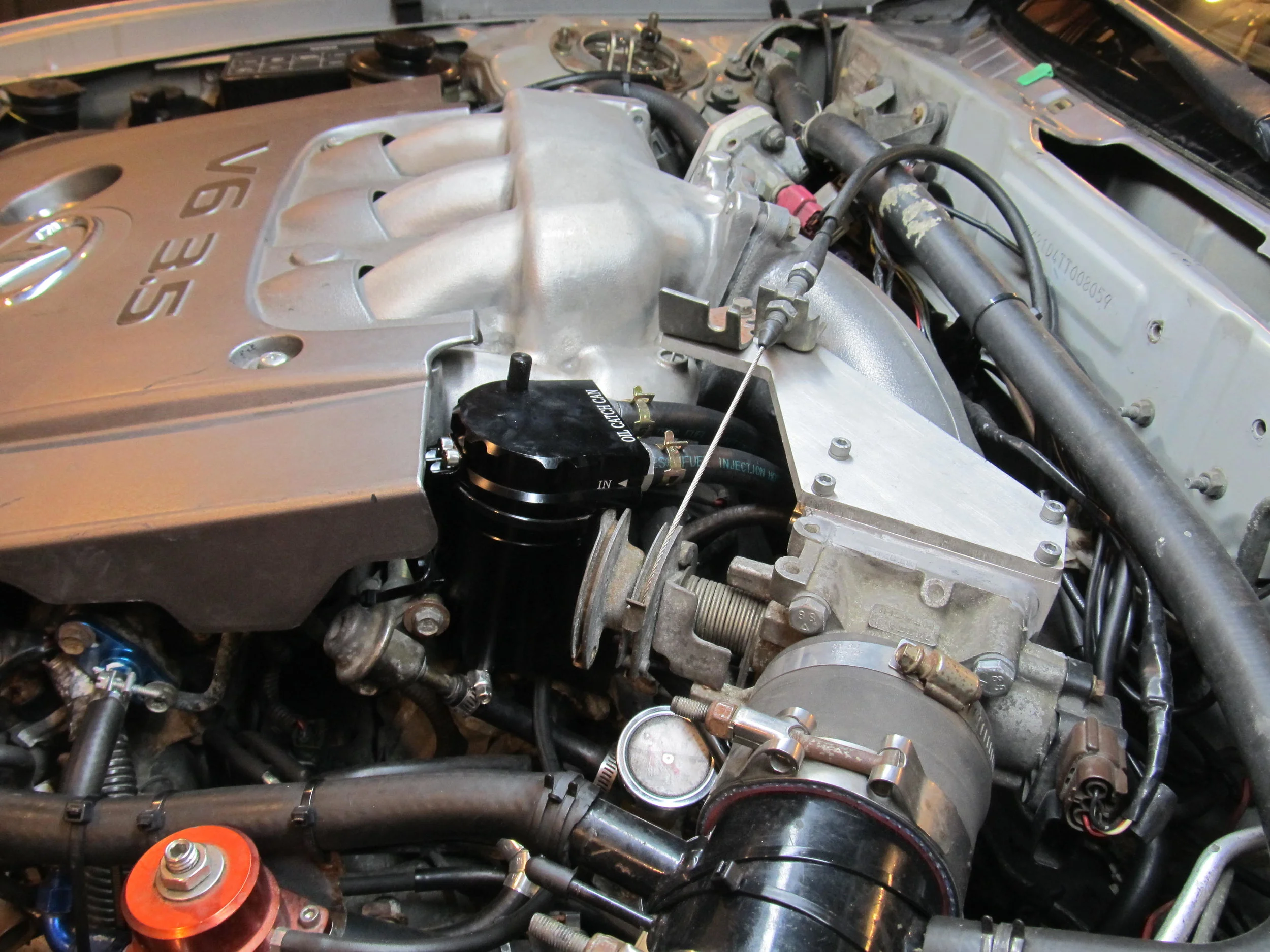

Time to tackle another overdue project- installing an oil catch can! I had one of the old Home Depot-style cheap-o catch cans when I had the DE-K in my car, but never got around to installing one for the 3.5. I bought a much better, but still very cheap can for $30 and got to work. I threw out the cheap hoses it came with and used my high pressure fuel lines instead. I played around with where to place the can, but couldn't find a good location that didn't require long runs of hose. Then I tried out a location by the throttle body, right where the older, and much smaller can used to live. It's a tight squeeze, but it works and it's out of the way, so in the end I'm pretty happy with it. It's easily accessible for easy cleaning too!
$30!
It didn't come with any instructions, does this look right?
The main o-ring came with a tear in it, I'm trying to get a replacement.

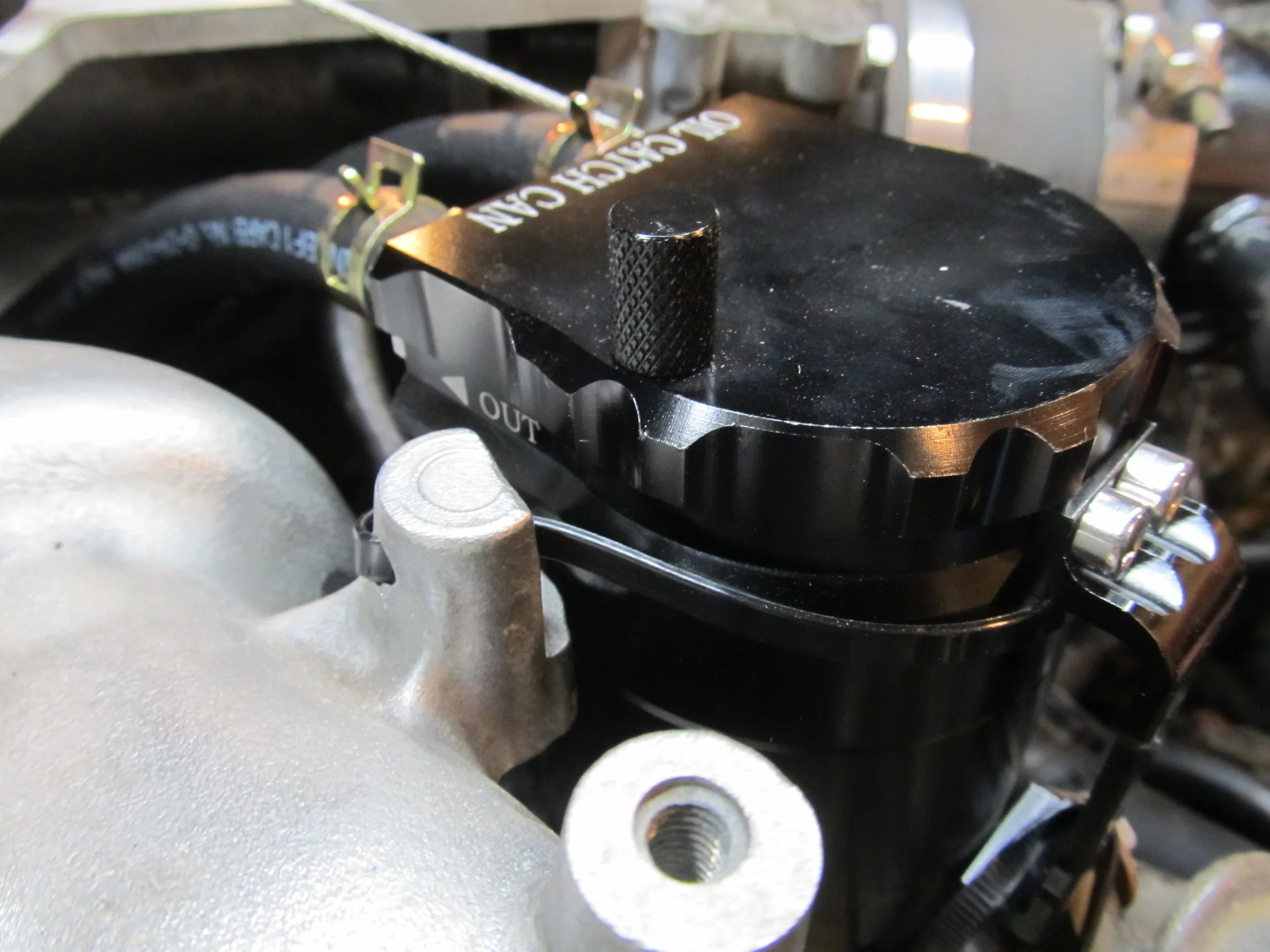

In and out locations:
The can is in a very tight area, and didn't actually require any zip ties to secure it, but I added them anyways.
Clearance is tight with the throttle cable!
But in the end it fits, and it's easily accessible, so I'm happy.
I then tried to do more troubleshooting for my water leak. It's coming in somewhere around the base of the windshield on the PS, but I still don't know where. I noticed some of the factory seam sealer was starting to crack in two areas at the base of the windshield, so I decided to apply some fresh sealer in the hopes it would stop the leak.
From above:
PS:
DS:
Unfortunately, this did nothing to stop the leak. The water is coming down somewhere below the base of the A pillar, but I don't know where. I can just barely see the base of the windshield from the inside with the A pillar cover removed, and I don't see any water there. I'm now thinking I need to remove my PS fender and inspect the area under there for cracks or something. With the HVAC stuff in the way, it's impossible to see where the water is entering the car. If this white thing wasn't there, I would be able to find it much better. Does anyone know if removing the white box means I need to drain the heater core?

You said you didn't "need" to ziptie the can but could it shift around any? It seems awfully close to the TB - no chance it could move and wedge it open? I've had runaway throttles on 2 vehicles in my life, often becoming pucker events...
Not really, the area it's in is very tight, and with the hoses attached it really can barely move. I'll inspect it the next time I pull the car in the garage though just to be sure.

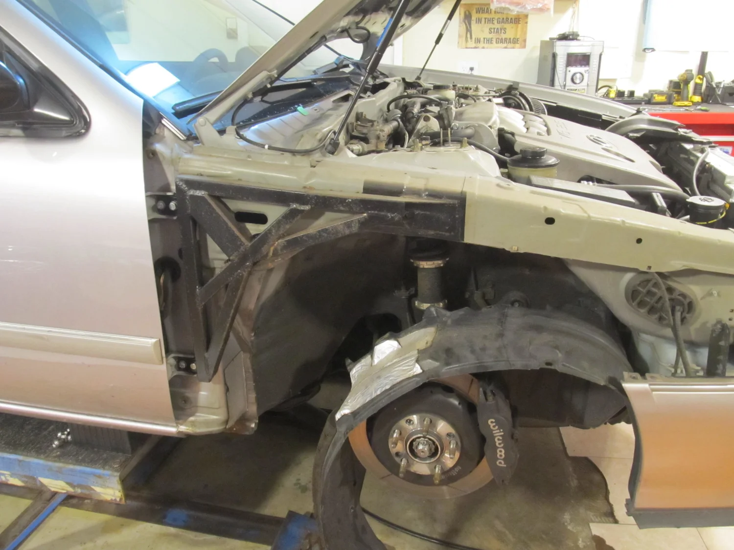

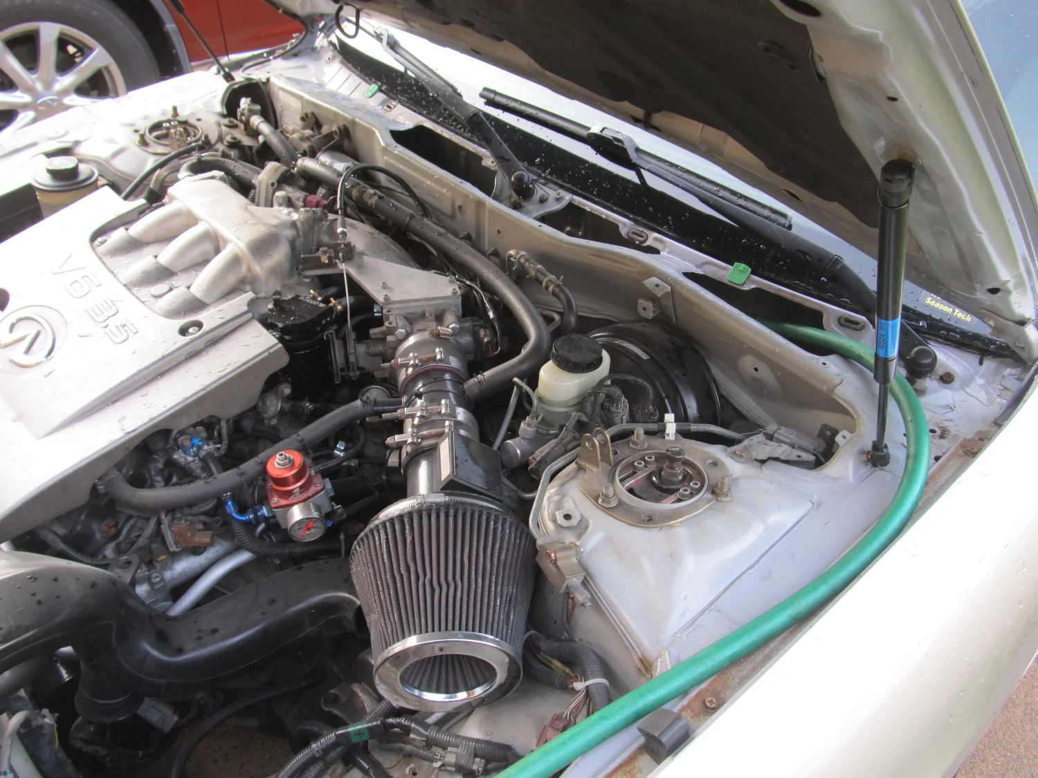

Time for an update, I need some more help!
It turns out that the water behind the passenger seat was actually coming from the front of the car, not the rear. That's due to my driveway being on an incline. I located a water leak somewhere around the base of the A pillar on the PS. I removed the A pillar cover, and as far as I can tell, the water isn't coming from anywhere around the windshield. I can only see it coming out from below, in this corner:
So I decided to remove the PS fender to see if there were any visible cracks on the firewall. Unfortunately, taking the fender off did little to help me see where the leak is coming from.
Here are some closeups:
There appears to be a drain hole beneath that large oval hole:
I was able to clear out some debris by sticking my vacuum into the large oval hole, and I think some of it was semi-clogging the drain. I took the car back outside and got the hose ready:
Sure enough, the water mostly drained out of the little drain under the large oval:
This is the view inside the oval hole:
The chamber behind that wall is where the intake for the HVAC is located. That intake sits inside a hole surrounded by metal about 2" high, preventing water from going into the HVAC. Here's a view from the DS:
With my hose putting out a lot of water, no water went into the HVAC. But it did come right into the car again! So this seems to point to the problem being somewhere around the HVAC intake on the firewall, and not higher up around the windshield. The only problem is that I can't see a way to access the area where the leak is occurring, none of the metal around the firewall is removable! The only thing I can think to do now is to remove the dash and/or the heater core. Can anyone think of any other solutions here? Am I overlooking something real simple and stupid? Here's a look at the heater core:
I'd be curious to know if anyone who is sending an A32 to a junkyard might be able to hack up the cowl area and take pics of what's inside. I get the feeling that sealing the crack from the inside of the car isn't going to be as effective as sealing it from the outside. Help!

Would a fiber optic inspection camera allow you to get inside and look around better?

I tried that once before, but maybe I should try again with the fender off. It's tough keeping it in focus and upright since there's not much light in there.

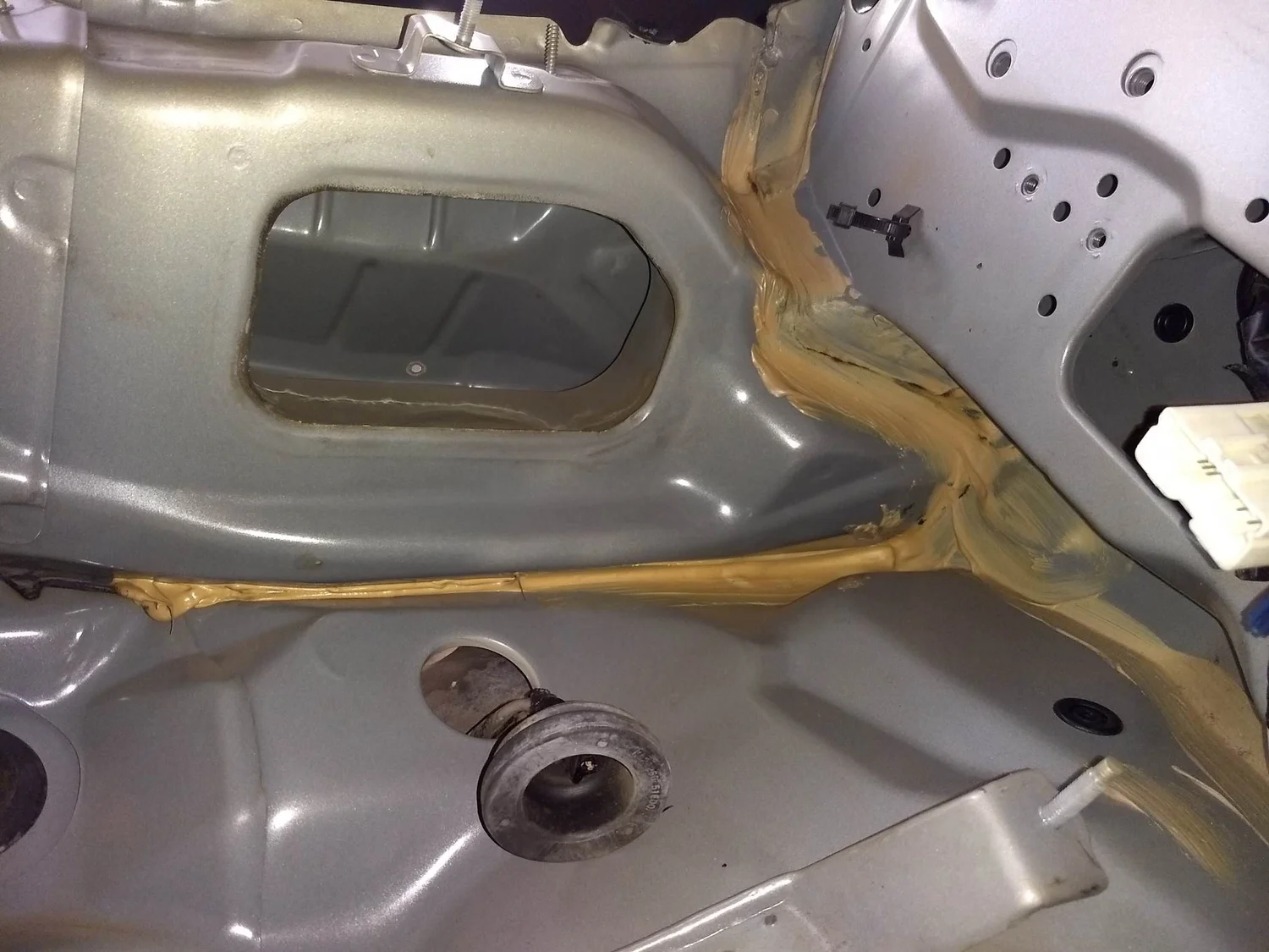

So Schmellyfart is taking apart a car to go to the junkyard, and was nice enough to snap some pics of what the inside of a 4th gen car looks like with the dash and heater core removed. These pictures are very helpful, and if you look close, you can see an area that is rusting, likely around where mine is doing the same:
So the pics are great, but even with this added information, I'm still struggling to figure out how I'm going to seal this up from the outside of the car. Is that even worth the effort, or should I just try to seal it from the interior? The area in the pics that's showing some rust is unreachable as far as I can tell from the outside of the car. I'm considering cutting the entire cowl off, and then having it welded back on, just so I can get access to the HVAC intake area. I'm kind of lost on how to proceed from here. Do I just rip the dash out, and hope for the best? Do I attack it from the exterior, and if so, how? Try to wriggle my hand in there and start blindly smearing goo all over the place? I'm going to play around more with my mini cam over the weekend in the hopes I can get a visual of where the problem is. Either way, thank you for the pics schmelly, they're greatly appreciated!

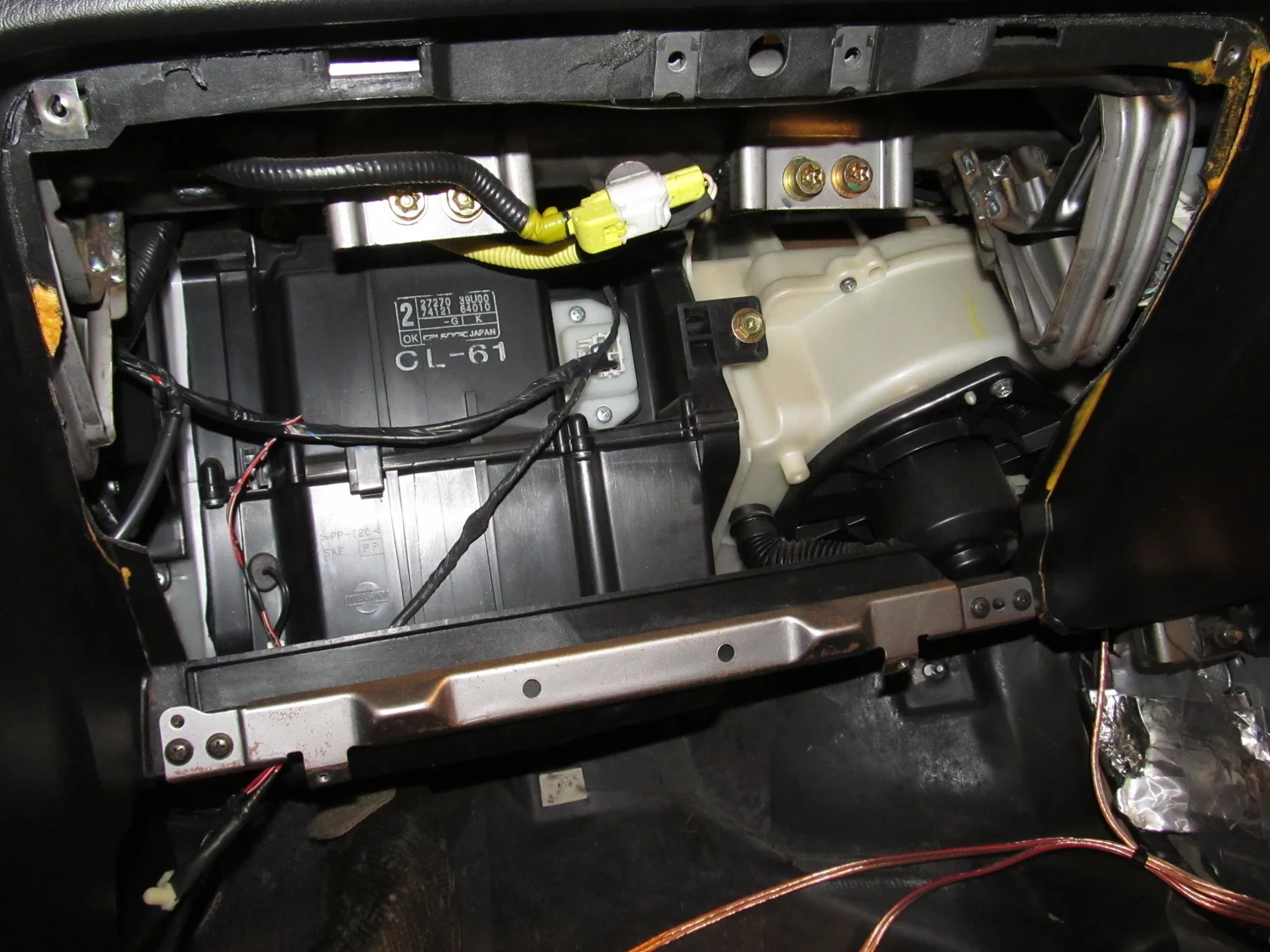

Pull your dash and see what you're working with.
Cutting and welding is a path you don't need to go down yet.
Stop being so reasonable! What if I pull the dash and it looks like the pics above, would you try to seal from the inside and hope it works, or go full crazy and cut the cowl?

I'd clean the area, spray rust converter, spray primer sealer and seam seal over it. I doubt Nissan put too much more effort into sealing it originally.
