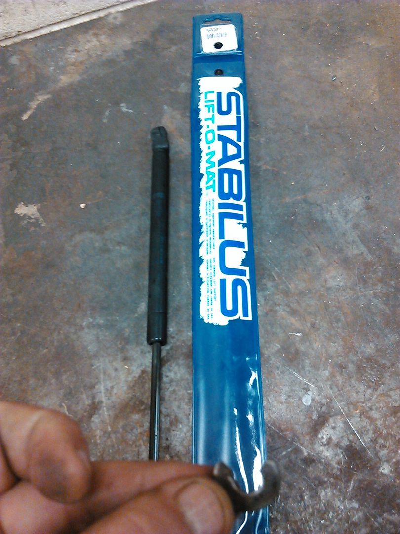

One thing that I see several times that is and easy fix is the hood struts do wear out and is and easy fix. The washer is for another fix I will show in the next picture.

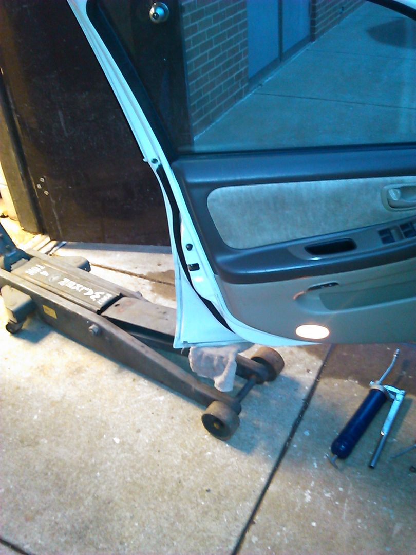

The drivers door had a sag and either from a heavy door or someone using the door to lift themselves out. I will eventually replace the top door hinge but am in no hurry for that. I put a washer in between the hinge and door. First I raise the door using a floor jack.

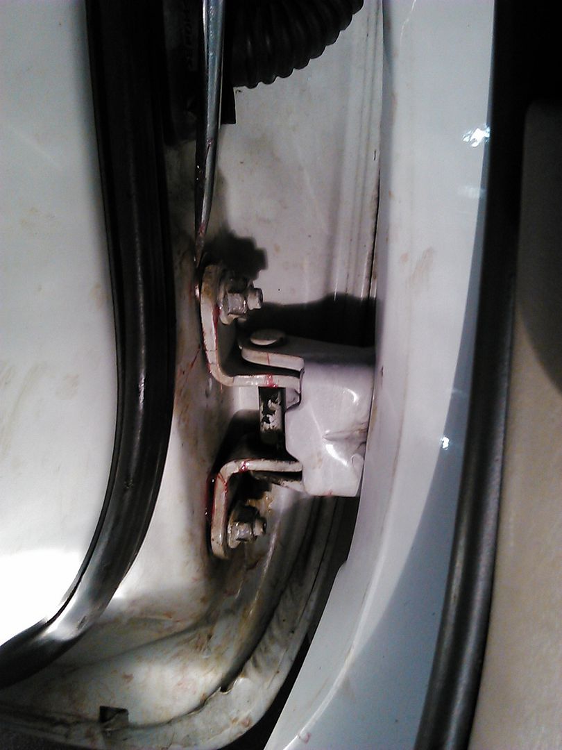

Loosen the nuts that hold the door to the studs and I slipped a washer in between the door and hinge. It is easier if the door uses bolts, so I had to notch the washers. I used two thin washers, one for the top and bottom studs on the lower hinge only. I use wheel bearing grease to help hold parts in when I need them to stay put in several cases so as I don't have to hold them.

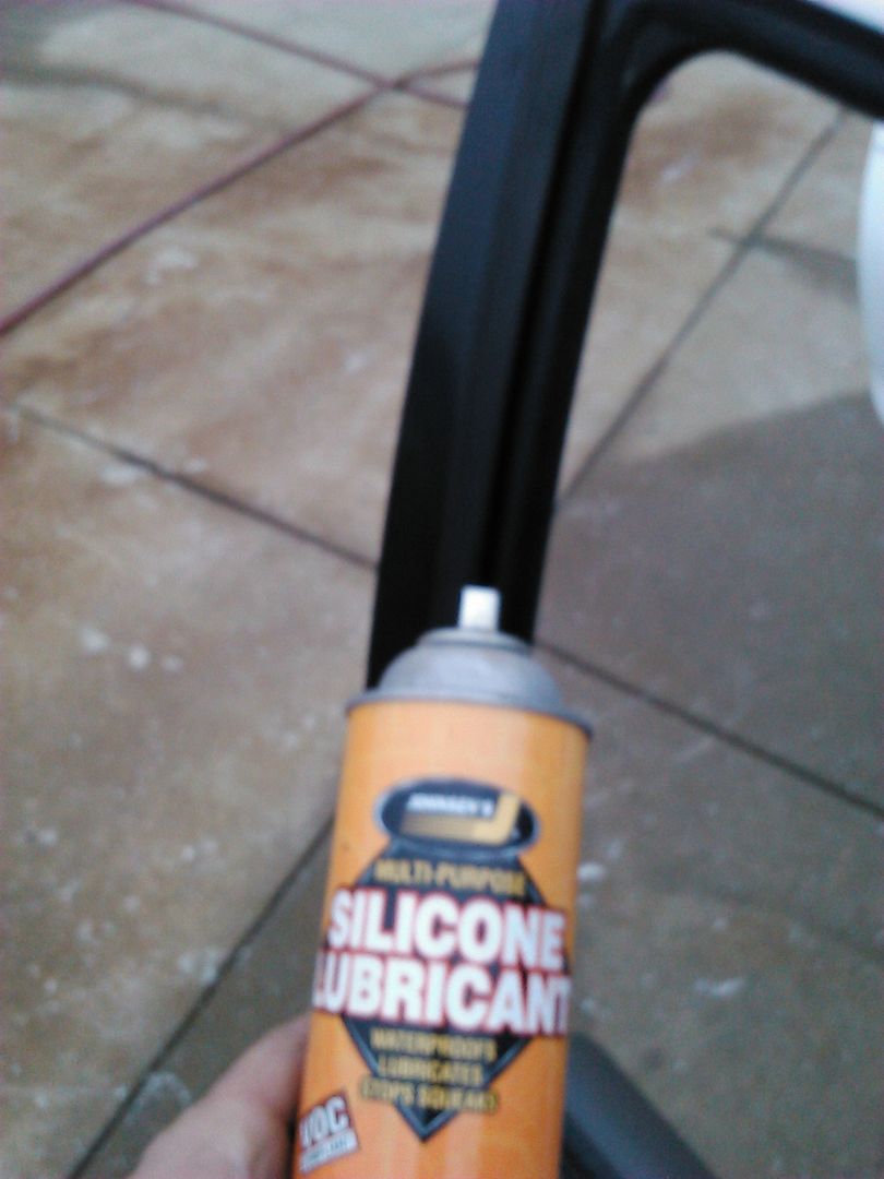

The window seals on cars and trucks do dry out and cause a lot of friction on manual or electric window motors. I just lube the seals up real well with silicon spray and can make a big difference on how easy it makes the window go up and down.

Got tired of the hood bopping me in the head and got new struts on. One way I learned Toyota trucks so well was I would go thru a Haynes Manual, Youtube videos, Yotatech, and then go to the boneyard and disassemble a truck without ripping things apart like it was my own. I still do that when I find a truck in the yards so someone can just get the part they need and to keep me refreshed on how these trucks assemble and disassemble.
