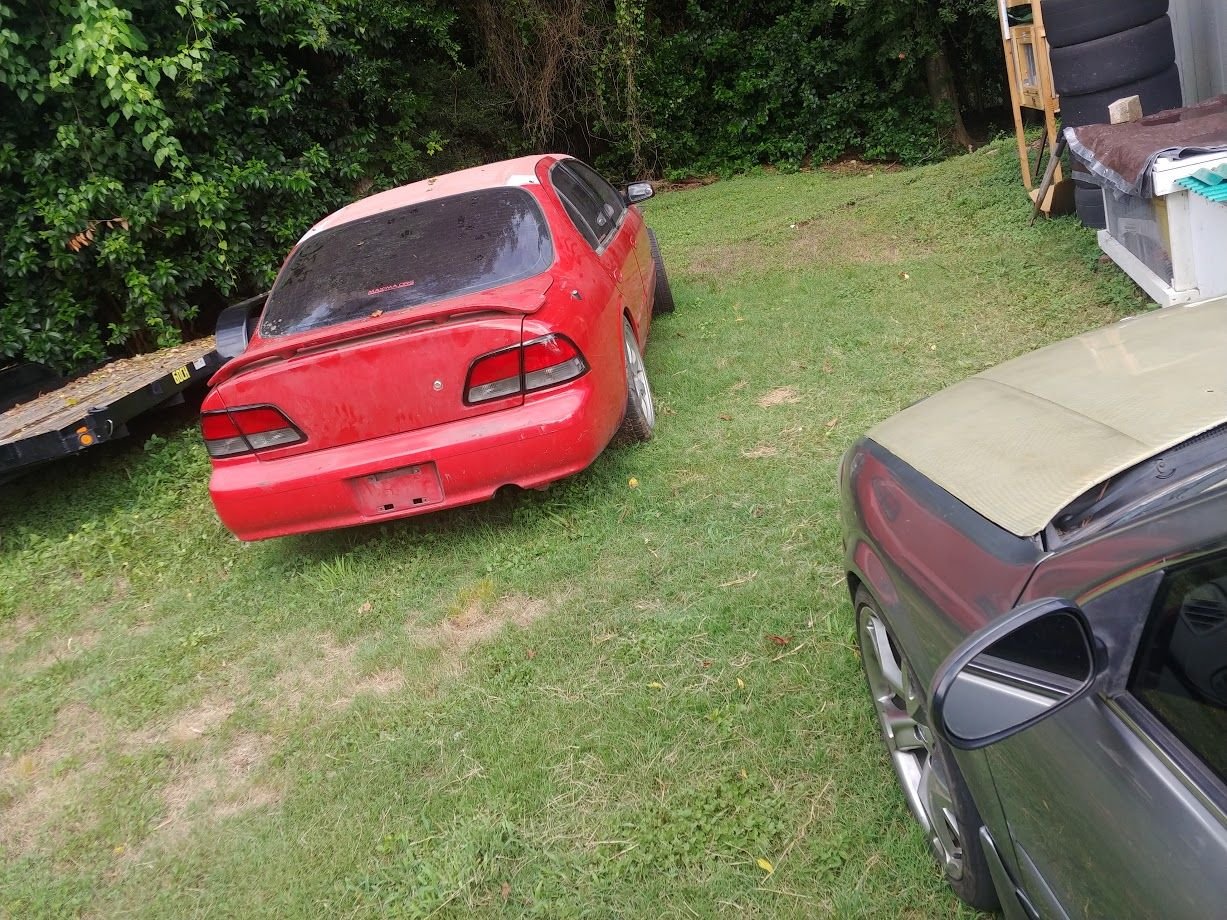

aackshun's Avatar
Posts: 5,398
Worked on the rear brakes today....
Welp I had issues loading it onto the trailer, brakes didn't work, so I ordered a pair of rear calipers and well too my surprise....
Back right caliper cable brake was not working, the arm would fully actuate, but not clamp on the pads.... So I replaced that whole caliper.
-Yes I know, white calipers..... Scroll to the top of the thread you'll see why I went ahead and painted them white....
I forgot to tighten the left rear caliper brake line.
Bled the brakes.....
Surprise, surprise, brakes work again, both hydraulic and cable.
-Its mah fowf and fiiif gen!
Up next are fenders and sunroof. I will give the lights another week because I reallllly want an AE mod lights again but they're sold out on ebay and amazon.... unless someone has some AE modded 4th gen lights for sale??? I'm too lazy to do them on my own again.
