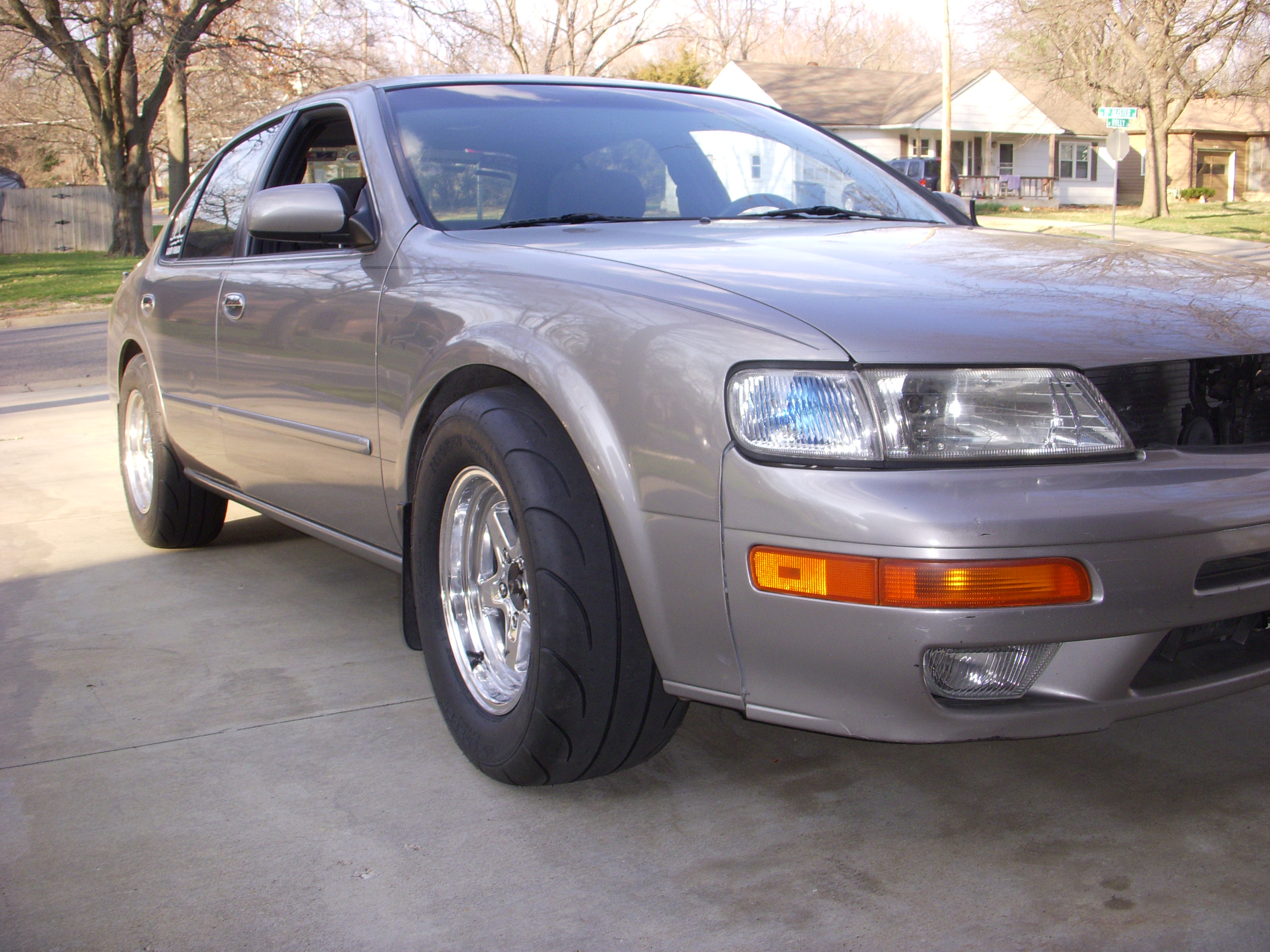

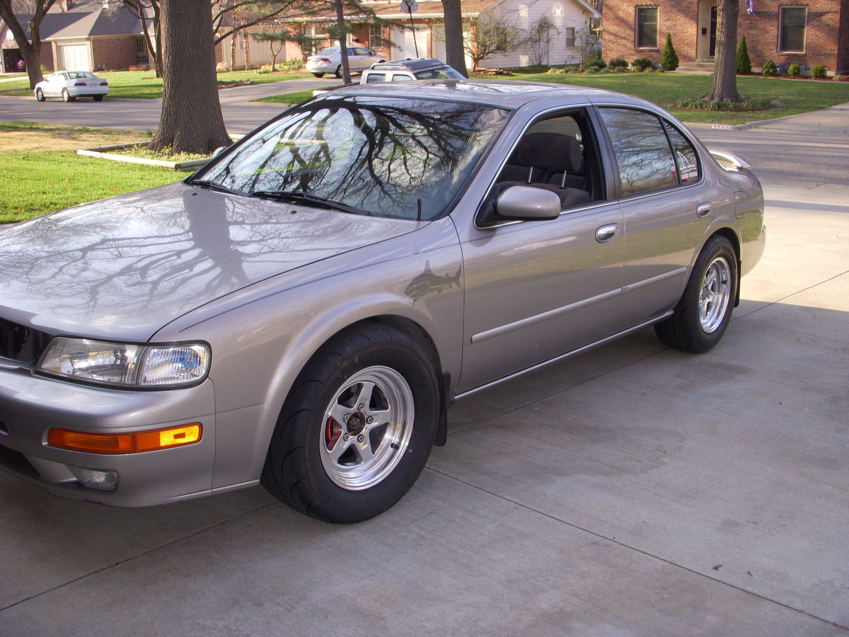

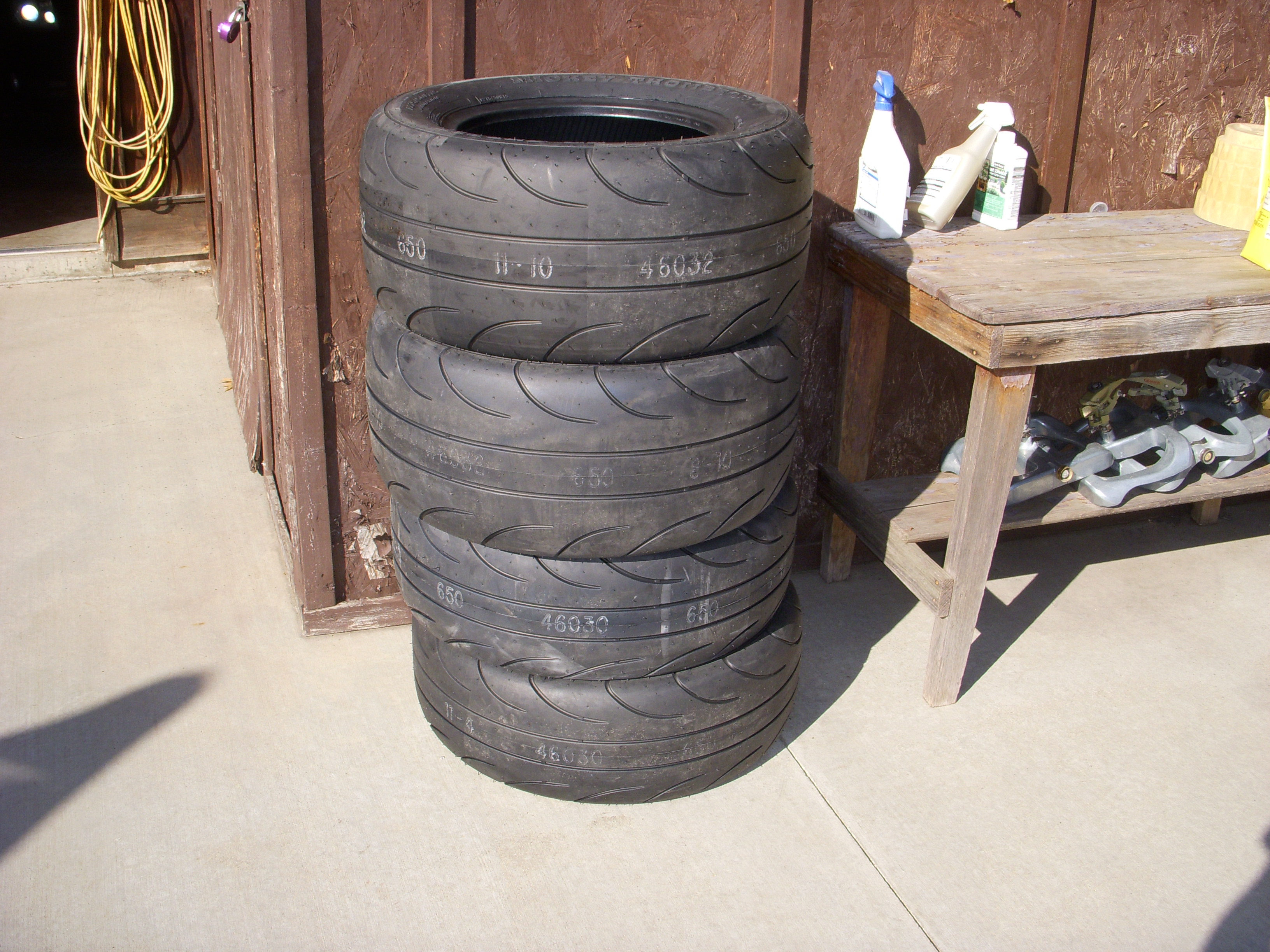

New wheels and tires?
I've been thinking about new wheels and tires for the coming season. I'll need drag radials for street-legal classes, and matching wheels (which also match the wheels for my M&H slicks) could be classy, but I also want tires that will corner well on the street and road courses.
AR-23 Wheel: 15x8"
Four of each should do it...
M/T ET Street Drag Radial: 275/50x15
Old Feb 17, 2012 | 03:40 PM

Old Feb 18, 2012 | 12:59 PM
  #741
grey99max's Avatar
LandShark has Cosworth
iTrader: (12)
Joined: Jan 2004
Posts: 4,327
From: Topeka, KS

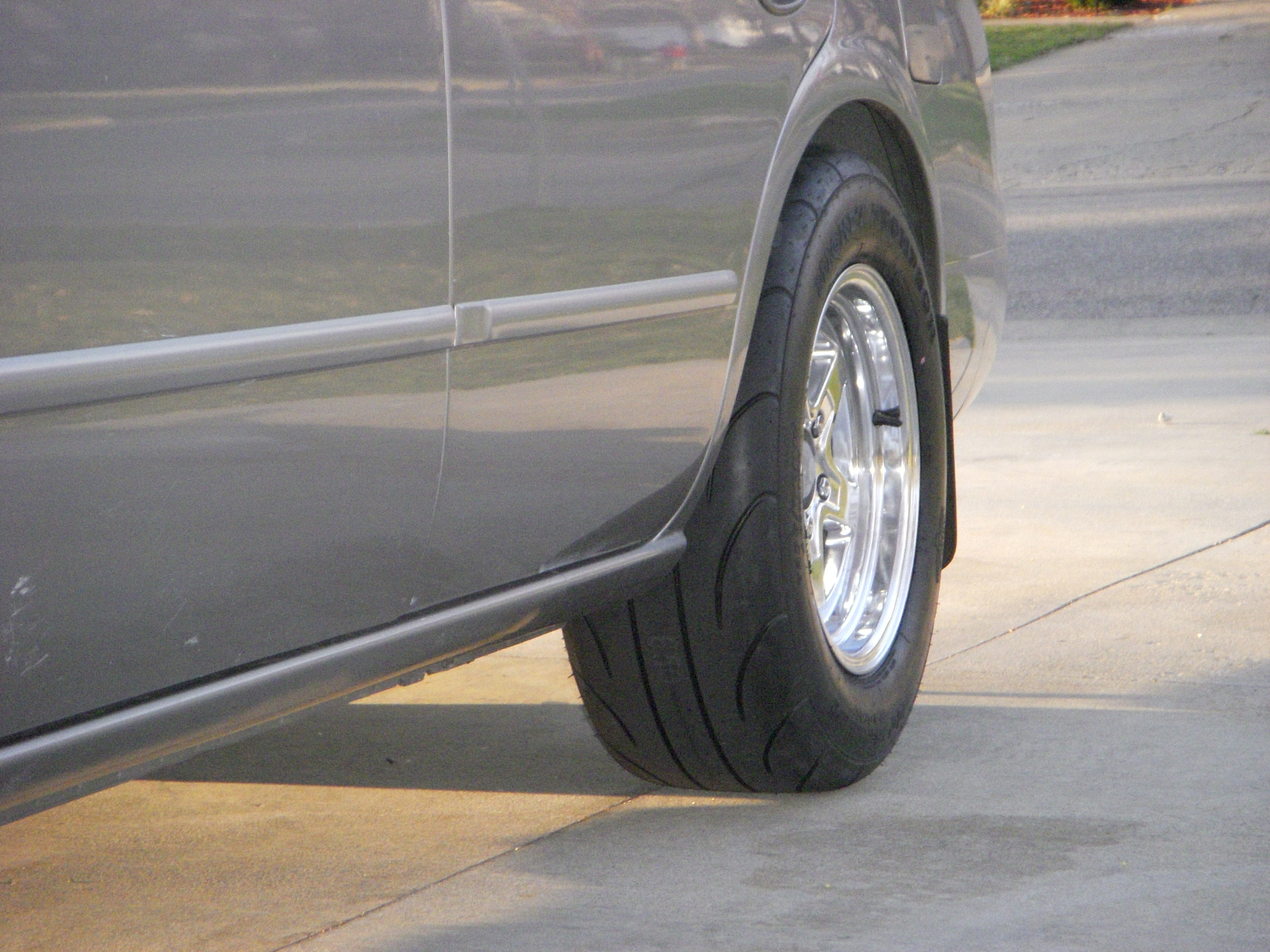

Originally Posted by Kevlo911
I like the wheels
I need 6" back-spacing for the 275 tire. That's what my ASA JS5s are for the BFG DRs that have 9.7" tread on the ground. I can't find an AR-23 wheel with that much back-spacing. I did find this Summit polished wheel in 15x8 5x4.5 lugs and 5.5" BS. I think I like them. Maybe I'll order one wheel and one tire for testing front and rear mounting.

I wonder if you'll hook with those tires. Seems like fwd cars really need the slick.
There are some "street legal" classes at different tracks that don't allow slicks. Nitrous cars can have other requirements, too. I went through all the tracks that I might visit in Missouri, Kansas, Oklahoma and Texas and looked through the track rules and requirements for special events for Street Legal and sometimes you gotta use a DR (and closed exhaust). I'm also planning on joining the local Heartland Road Warrior group for driving too fast around road courses and I think that this tire (with R2 rubber) would work well for going around corners at speed. This tire is also good for highway driving, and I don't find any other DRs that agree to that. At least that's my thinking right now.
The closed Ark City strip has been purchased and plans are to re-open the track. You'll need to register to read this Link to Wichita Racing Forum:

Yesterday I replaced the PLX wideband sensor, and now it keeps working, so I guess the sensor was the problem. Before, with a cold start it would display normally and then go up to 19.9 on the display after a few minutes. Working all the time is better.

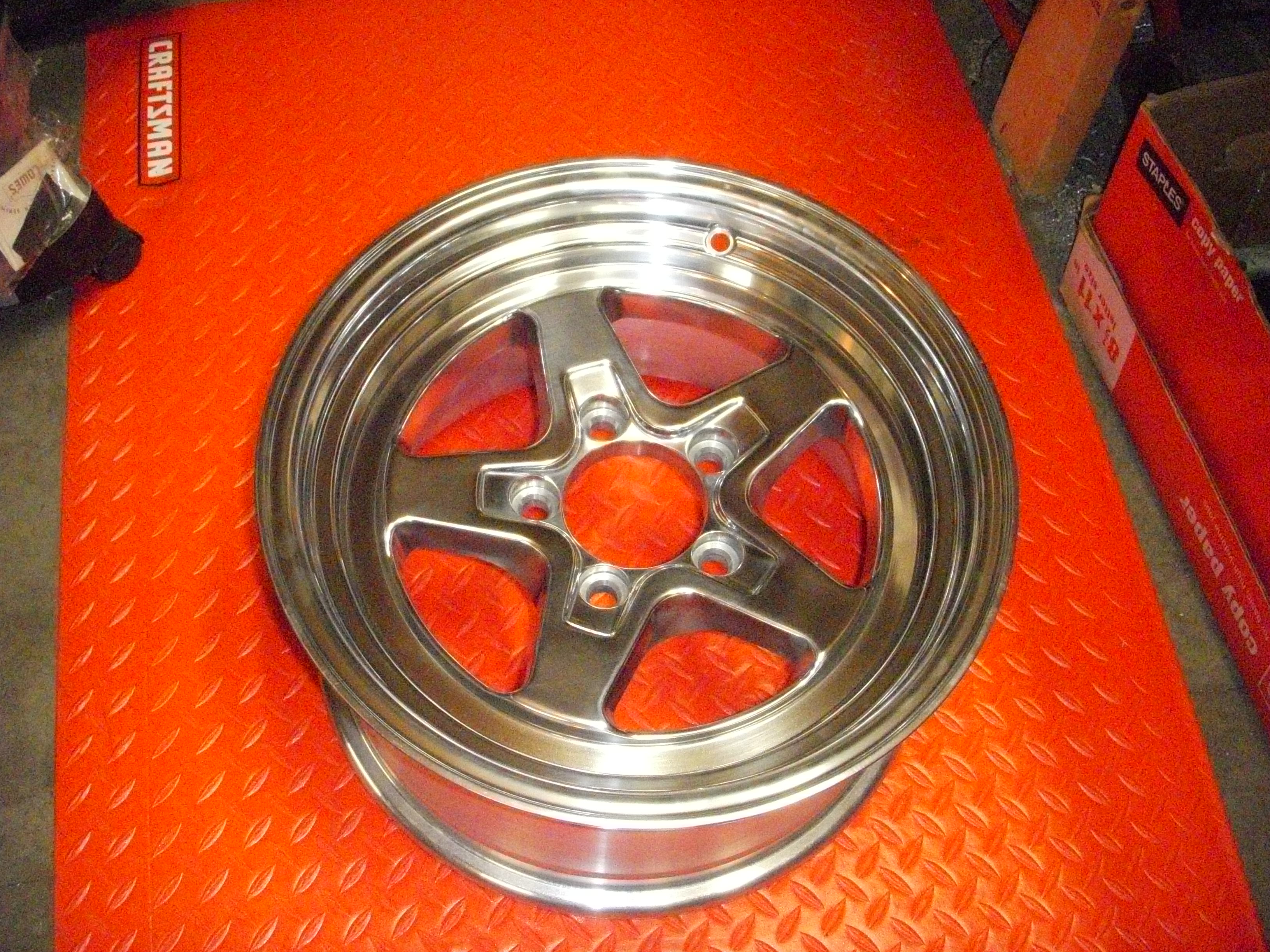

I ordered one 15x8 Warrior wheel from Summit Racing, to check the many clearance issues you can have with a 4th gen. If the wheel mounts up with no hub clearance issues then I'm going to order the other three and the two pairs of M/T ET Street DRs I've been talking about. The rear BFGs are starting to show tread separation of the top cap from the rest of the tread, so it's time to do something. I think they're 6 or 7 years old - time to go.

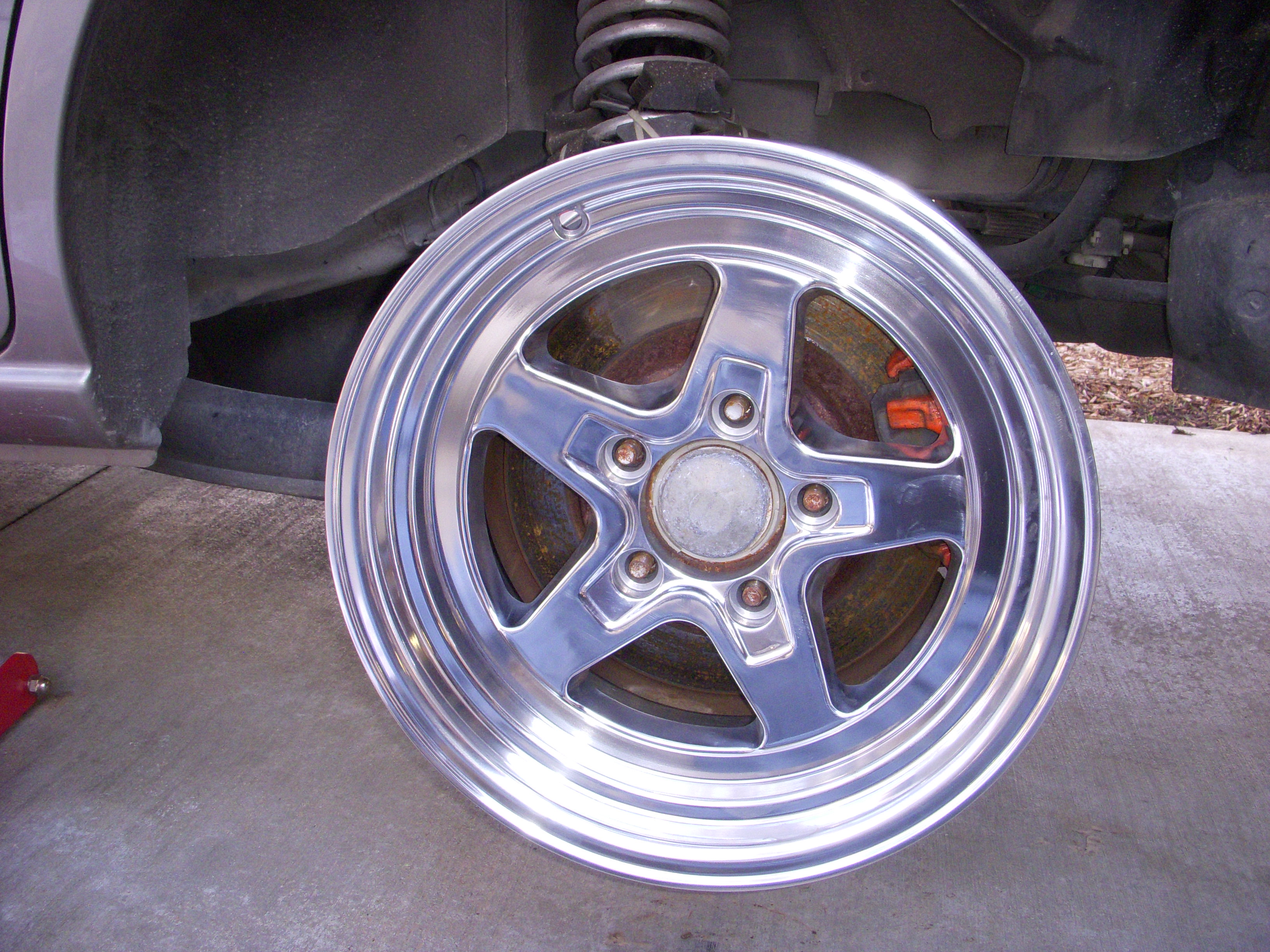

Originally Posted by aackshun
What kind of backspacing is on that wheel? And the weight?

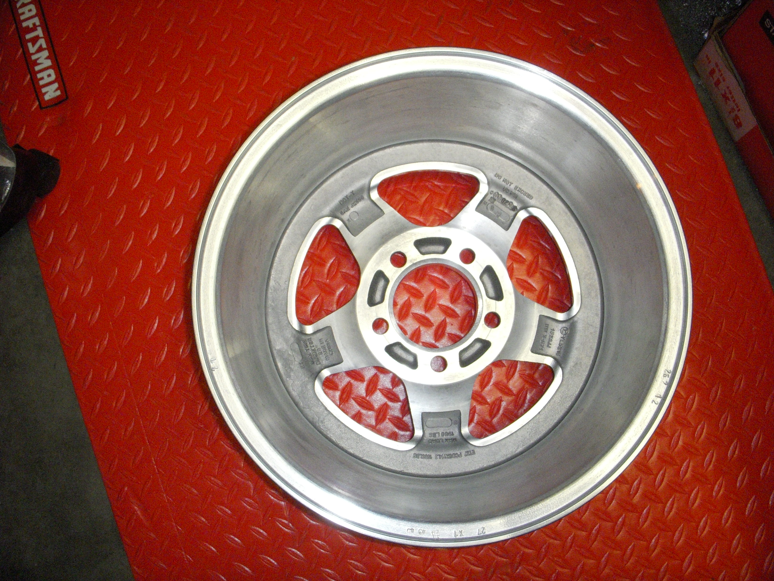

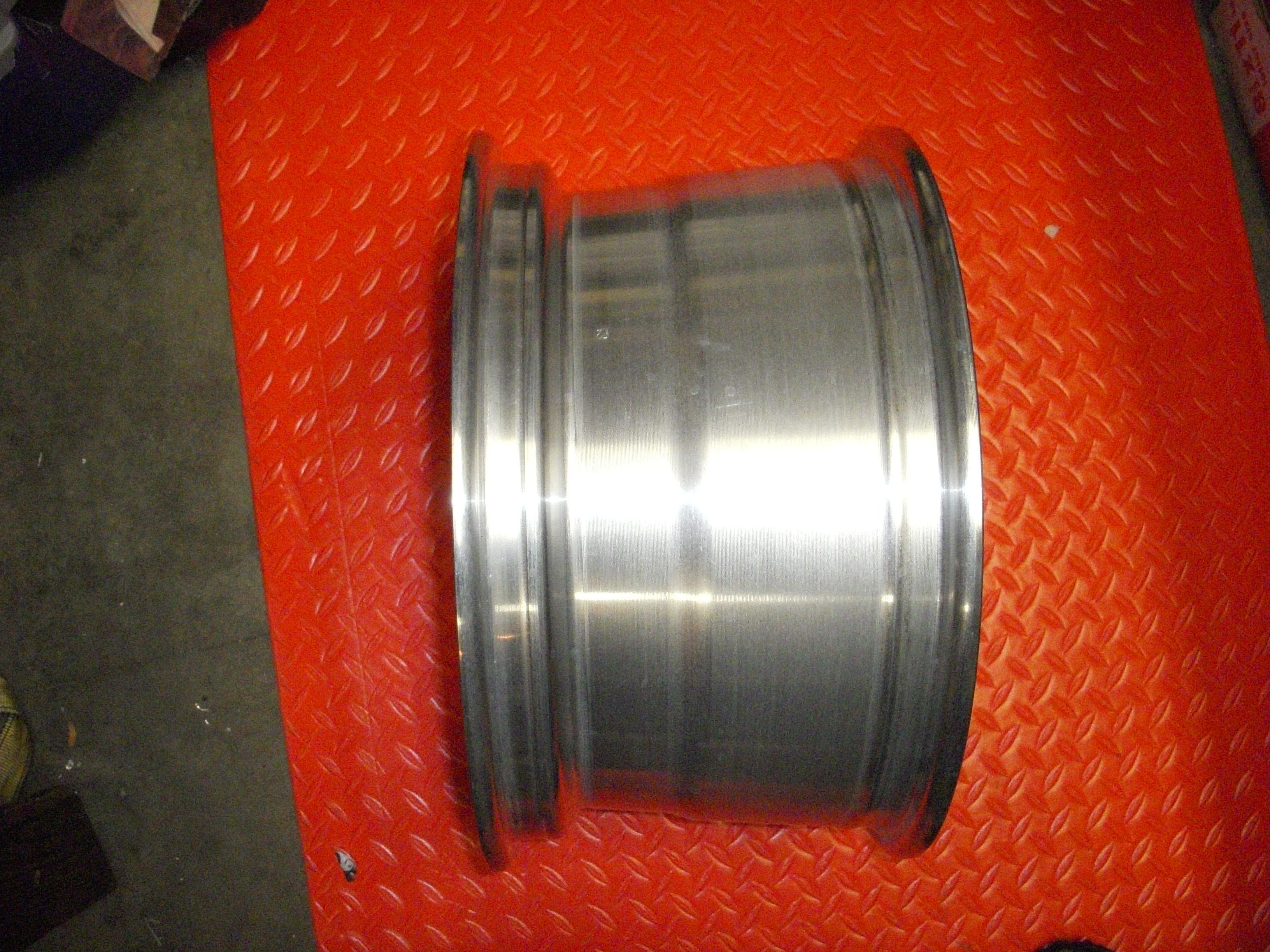

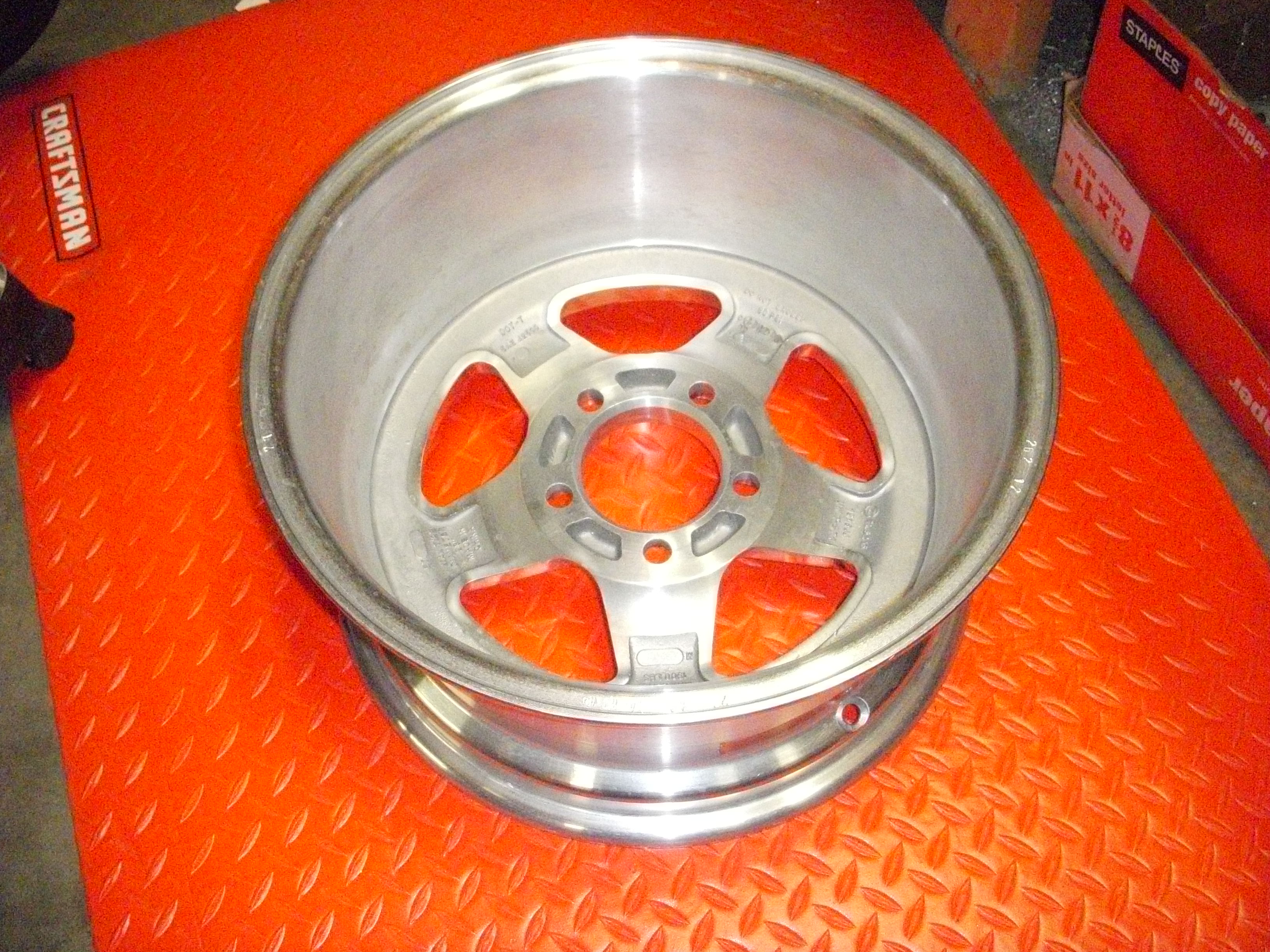

The Summit Warrior RT I bought is 15 x 8", 5x4.5", 5.5" BS, and some offset or other. 27mm, looks like.. there are other configurations, but this one worked for me.
Here is a link to that wheel: click on the MORE DETAIL tab for more details. I haven't weighed it yet - guess I should, but it's pretty light - and cheap, for now. And everything clears....
http://www.summitracing.com/search/D...n/?Ns=Rank|Asc
EDIT - Followup - my wheel weighs 18.2 lb. Not especially light, but they need to be strong.
EDIT #2: These wheels are CNCed from one chunk of aluminum and made in China.

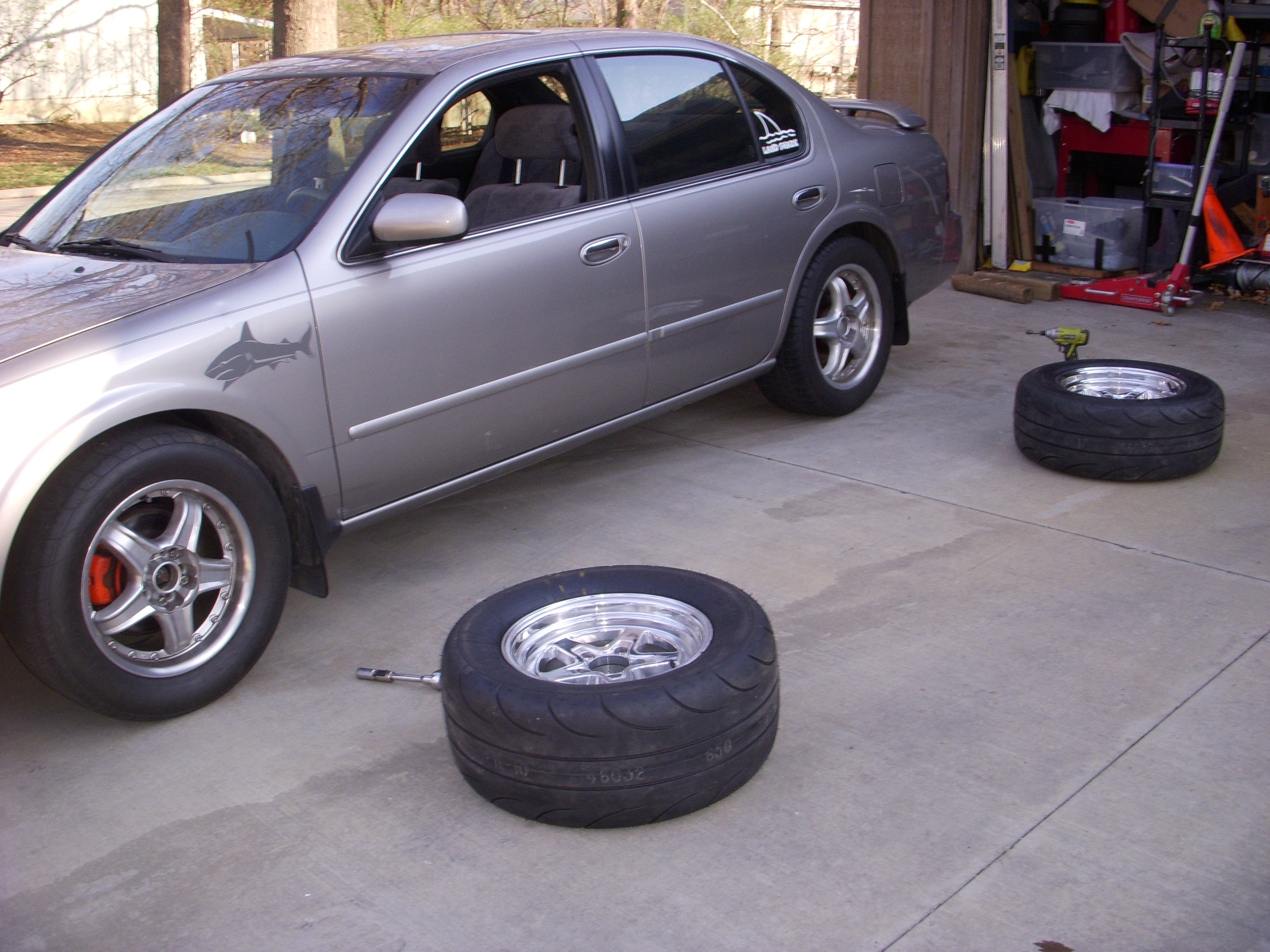

Last night I ordered the other three wheels and the two pairs of M/T ET Street Radials.
