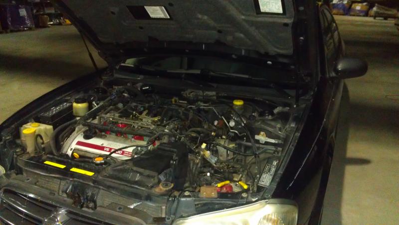

Originally Posted by rjfoste12
I pulled the intake manifold tonight. Back bolts on the drivers side are NOT fun. Also cut off the end of the bolt for the egr tube bracket, removed the tube and cleaned it out with carb cleaner. The tube was completely blocked. Could this be what was causing the car to stall at idle? Either way, its clean now, along with the throttle body and IACV. Going to the dealership in the morning to try and get some gaskets. I hope this fixes my issue..
Attachment 2828
It can be related and you'll find out when you get it all back together and started up. Let us know.
The EGR tube is a definite PITA. When I went through all my EGR parts it took me a few hours to get it all disassembled. Then an hour or so to get it back together. Patience...
Well, it's done. Ended up doing EGR Tube, UIM, Both valve cover gaskets and cleaned the throttle body and IACV. Car runs great and is not stalling at idle. I do have a problem still though. On my UIM, followed tightening procedure and torqued to 15ft lbs, well the bolt on the front left broke??. There is a vacuum leak coming from under the intake manifold as well. Im hoping the UIM didn't crack. I sprayed carb cleaner around, but could not pinpoint the leak and no change in idle. I guess i'm tearing back in to it this weekend with a new (junkyard) UIM handy just in case TO my surprise, the car is running excellent, even with the leak. I just know that bolt is broken and I'm not the type to just leave it, even if it means tearing it back off. any suggestions before I do this?

Hello I'm new. I have recently acquired a 2001 Maxima M20 with 147.000 from a small dealer with a small warranty. After 200 miles on it the service engine soon light came on{looking back, it was surging a bit} I took it to autozone and got codes 0420 and 0430. I foolishly let them clear the codes and then proceeded to the state inspection. Turns out they couldn't read it and they told me to drive it out and if the lights stayed off come back for the sticker. Since it's the holidays I couldn't address it and continued to drive about another 140 miles before it started acting funny. First we smelled burning and pulled over. Then it started idling up and down wildly so we put it on the OBD and it was the dreaded code 505 for the ICM. I've read all around about how it takes out the ECM and AFS etc. My issue is my measly warranty and how to approach these extensive repairs. I have a deductible of $100. each visit and a drive train 6/6.000 miles. I cannot allow them to $100 me to death for all these electronics 02 sensors and cats. Any advice is much appreciated. I'll know more if I am deciding to get the carfax. After reading through it seems I will be needing this. Should I drive the 60 miles to the repair shop or have it towed? Should I replace all these trouble system parts at once?
