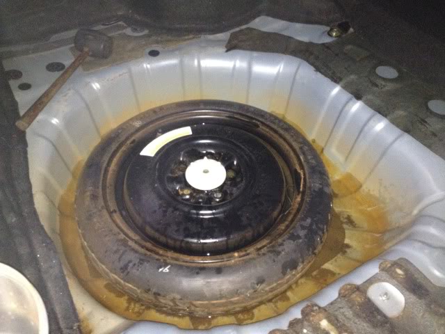

Ok, I'm having difficulty removing the spare tire from my trunk. What kind of a tool should I use? I'm a real n00b at this sort of thing lol.

Gavin, I would try to remove that white piece first, it shouldn't be to hard to unscrew. Then the tire can easily be removed. If not I would take a crowbar to it. Don't know how safe it would be to drive on that spare the way it looks.

That round white plastic disk in the center is esentially a nut. It screws off like a regular nut. Turn it counter clockwise. If it is super tight, let the air out of the tire. Someone may have put the tire in when there was no air in it, screwed it down and then inflated the tire. Then fix your leaking tail lights.

If it's too tight to turn by hand, you can use a T50 Torx bit to remove it.
