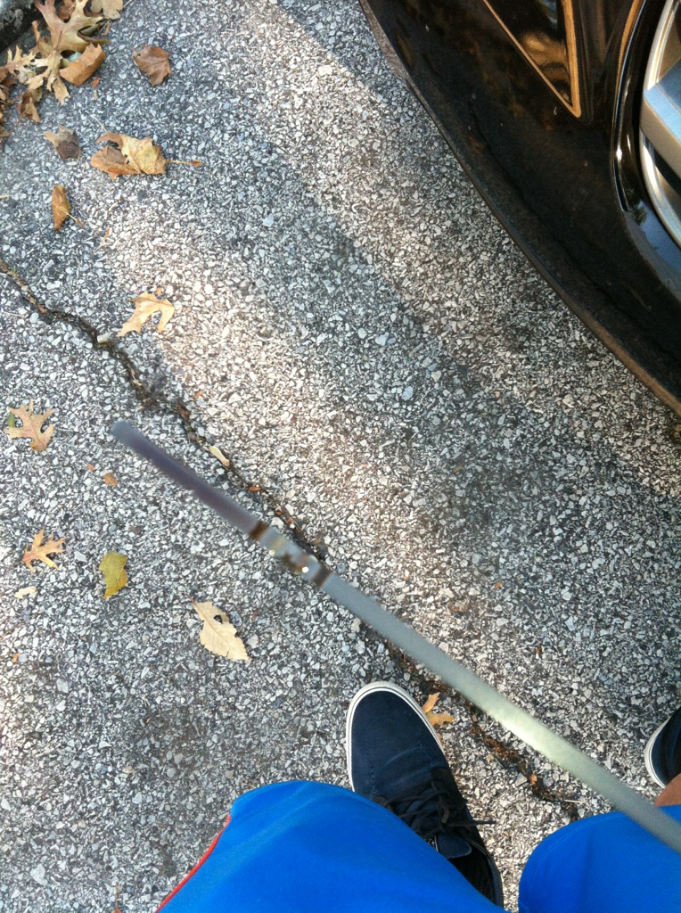

where is the tranny fluid on my a/t 5.5

^^ It *should* be in the transmission...
The dipstick is just to the right of the engine cover. The drain plug is on the bottom of the transmission, 19mm bolt.

I can't really smell it but it's DARK
Time for fluid drain and fill?
img snip
Yes. Supposed to be obviously red. That is obviously brown.

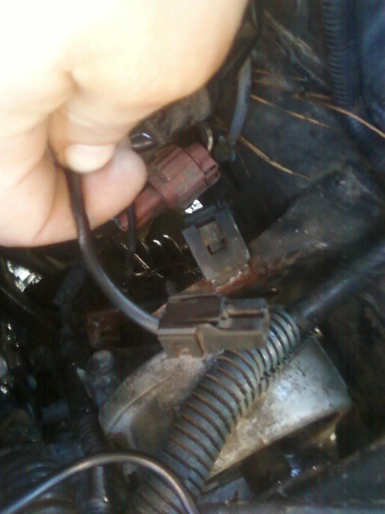

2000 Max GXE - SES, Battery, Oil Lights On
Hi all,
Two months ago I bought a used 2000 Maxima GXE w/ ~43k miles on it. It was running fine up until recently. When the car is running and in park for more than ~30 seconds the engine shuts off and the Service Engine Soon, Battery, and Oil lights come on. This has also happened when I'm sitting in stop & go traffic, moving at very slow speeds. I'm considering replacing the MAF sensor and possibly the O2 sensor. I would appreciate any and all opinions on this problem. Thanks in advance!

Originally Posted by WattAce
Hi all,
it's your MAF sensor, this sounds exactly like what i experienced when i first got my maxima
Hi all,
The lights in the dash being on (SES, Oil, Battery, Oil) are normal for when the engine is not running. Is the SES light on when the engine is running?
Why are you considering changing the O2 sensor? It's very rare for an O2 sensor to cause a problem like yours.
Take the car to an auto parts store and ask them to read the codes before you start blindly throwing money at the car.
No guarantees that the MAF is causing your problem, either. Cleaning the MAF does not always "fix" a bad maf, so no guarantees on that. But it won't hurt. Also clean the the throttle body while you are cleaning things.
Thanks for the reply. None of the lights are on when the engine is running, including the SES light. They only come on after the engine stalls. I'm not very familiar w/ O2 sensors so that was just a wild *** guess I threw out there.
As for the MAF, I'm probably going to put that idea on hold temporarily. A coworker of mine suggested cleaning the throttle plate, so I'm going to do that tomorrow before I spend any money on parts. Does this sound like a reasonable idea? Also, I'm going to check the air filter like you suggested picnik99. How will I know if the filter needs to be replaced?
I appreciate the input as this is my first car, so I'm not familiar with most routine maintenance procedures just yet.

Your co-worker and I are talking about cleaning the same part. The throttle plate is in the throttle body. Air filters are a normal change-on-a-regular-basis type of item. Nissan recommends every 30K miles. If you take the filter out and look at it and the side that the incoming air hits is all black, the filter change is overdue. Similiarly, if you don't know when the filter was changed, go ahead and do it.
Thanks for the reply. As it turns out, the throttle plate was the source of my issue. There was a good amount of buildup on the edges so I cleaned it off as best as I could. I'm no longer having the stalling issue while in park. I appreciate the responses guys

I've looked over previous post the last several weeks hoping to find a solution but I didn't see any related threads/post like mine. If I did over look any similar solutions I apologies & would appreciate a point in the right direction. My 2000 Max was/is the first car I bought/afford on my own means a lot to me but not tha WIFE!! That being said:
Had cooling system problems last couple weeks I've: (1) flushed radiator, (2) replaced thermostats, (3) fan entire assembly along w/resistors & fuses.
Was doing fine until this morning saw a small softball size puddle under Driver Side Wheel /Air Intake System - Reservoir tank was Bone Dry & Radiator was about half a liter low. The puddle/stain doesn't look that bad. I'm worried could be other issues or something I overlooked.
The IACV (Intake Air Control Valve) that is part of the throttle body, has engint coolant flowing through it. Therefore it has 2 small hoses attached, which could be the source of the leak.

Ground wire?
I just replaced the motor on my 00 maxima and have one ground wire left. I cant see to figure out where it goes. Its about 6 inches behind my driver side motor mount, can someone please tell me where this goes? Thanks in advance!Name:  102312110631_zpsdefa6e27.jpg
