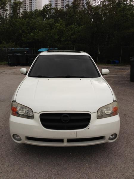

Got a ticket for my windshield tint 35%
Attached Thumbnails 5th Gen "I AM NEW HERE BUT HAVE A QUESTION" thread-image-1061829859.jpg
windshield tint is illegal in pretty much every jurisdiction unless you have a note from your eye doctor... At least, more than like 6 inches from the top anyhow
