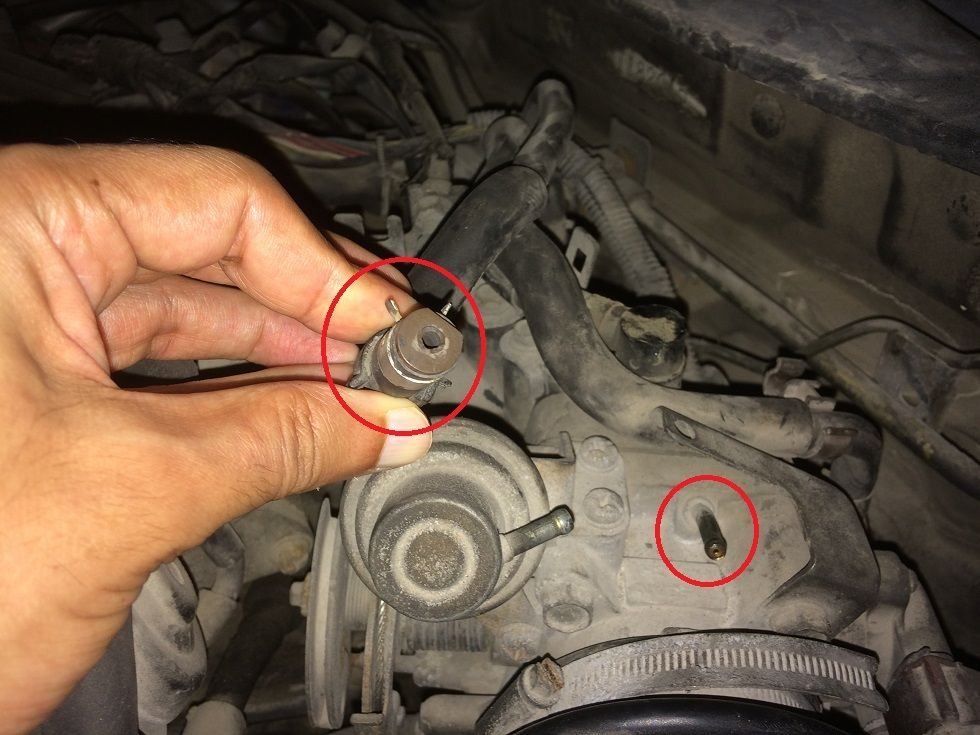

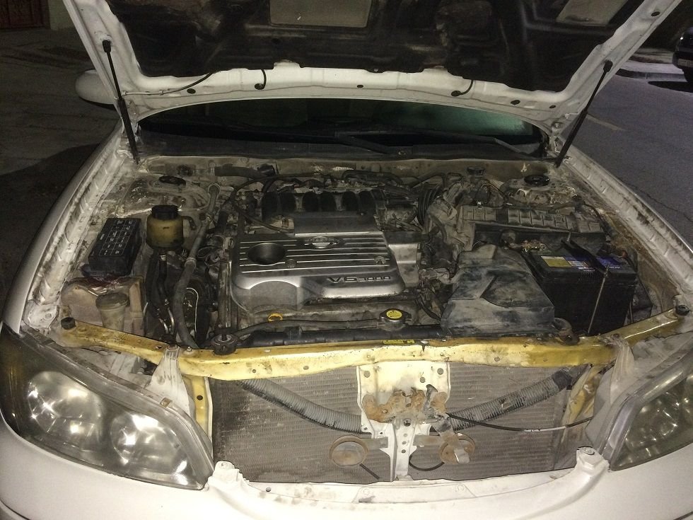

What is missing at the throttle body?
I drive 2000 model Nissan Maxima. When I start the engine the RPM gauge doesn’t stay high. It drops quickly too low and usually the engine will shut off. So in order to keep the engine on, I push the accelerator pedal a couple of seconds right after the engine starts. And if the engine is cold, I keep pressing the accelerator pedal longer trying to simulate the normal revs of a cold engine, and I gradually release my press to allow the revs to drop off as they would normally do.
However when I take my food off the pedal, the gauge stays between 500 to 800 RMP, and the car starts shaking a little bit. And more surprisingly to me, when I turn on the AC, the revs drop lower instead of going up! And when I put the car in gear they drop even further. And the car will shake even more.
I noticed something unusual at the throttle body and have taken these pictures. Both that hose and the barb suck air when the engine is on.
Do you know what’s missing here?

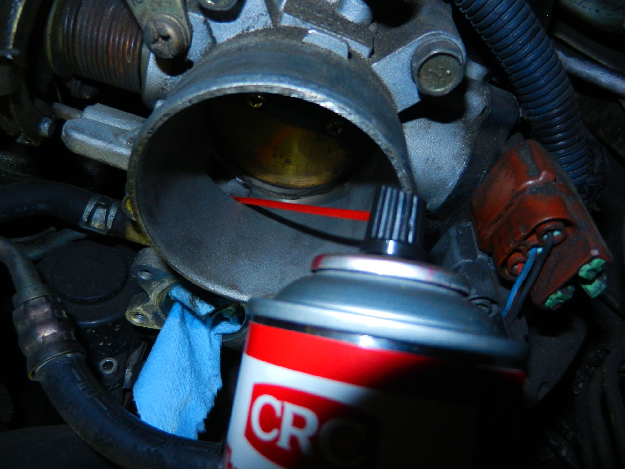

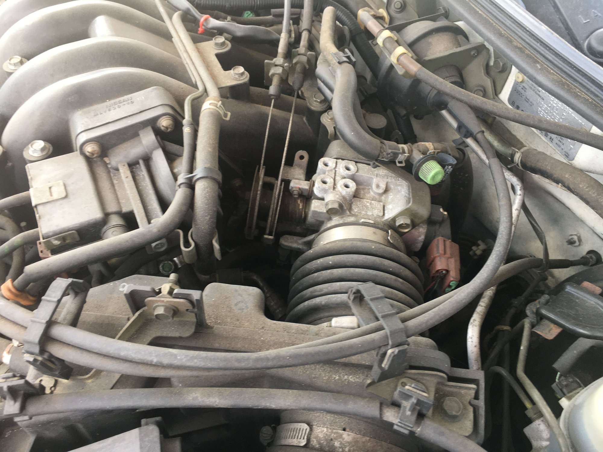

Welcome to the MAXIMA threads!
You say that you drive a year 2000 Maxima, however, the Engine does NOT look anything like my USA 2000 Maxima GLE???? My 2000 Maxima does NOT have those hoses nor that Vacuum Unit on the Throttle body??
In any case, my Maxima had the same identical issue. However, my particular problem came gradually as it started well when COLD and then, at the STOP Light or STOP sign after completely reaching normal Engine operating temperature the Engine RPMs got very low and it died if you were not ready by compensating with the throttle. I cleaned the Throttle body and also cleaning the IDLE AIR VALVE assembly and that help for a little while but, it continued doing it.
I believe that these Engines that come with the Hitachi brand Mass Air Sensor (MAS) gets faulty and even though you have cleaned and cleaned the IDLE AIR VALVE assembly it will die because MAS is just not doing it's job and reporting how much Air is flowing to the Engine to the Engine Control Module (ECM). What "is" the MAS? It is a heater that get hot at a certain temperature and as the Engine starts and sucks Air through the intake air tube, it cools this sensor and then the ECM does a comparison and determines how much and it adjusts the parameters of the Engine. When this Sensor goes bad then, the ECM can no longer do a correct comparison and the worse is your issue, I believe. This is not to be confused with Engine running too rich as this is caused by the O2 Sensor.
Anyway, this was my Hail Mary fix and it worked!
Please read over at:
https://maxima.org/forums/5th-genera...ml#post9222598
I would clean the throttle body and clean "Carefully" the IDLE AIR CONTROL assembly and if that does NOT do it then, I would change out perhaps both the "ELECTRO MECHANICAL portion of the IDLE AIR CONTROL and the MAS.
Best of luck!
EDIT: THE PICTURES BELOW SHOWS MY 2000 MAXIMA GLE FOR USA, A CALIFORNIA CAR.
You’re right. I am not from the States. If what I heard is correct, Maxima here is Infiniti in the US and vice versa. And I have the same post in the Infiniti forum, but that forum looks completely dead.
I still need to find out the missing part or parts. But I’m curious; do you use seafoam for cleaning?
We have Infiniti in the USA as well, however, I have not checked the Engine compartment on a 2000 Infiniti that is comparable to the 2000 Maxima and see if your Engine is indeed the same as that of either an Infiniti of USA?
No, I used a Throttle Body cleaner that would not damage the MAS.
If you take off the IDLE CONTROL VALVE - Electronic-mechanical assembly MAKE SURE YOU DO NOT TURN IT and just Carefully Clean it!

Hi Dennis, you look knowledgable. Would it be possible for you to help me with my issue above titled "What is missing at the throttle body"?
I've already found out that one short hose goes from the barb on the throttle body to the barb on what I was told is the AC idle up actuator or idle speed control (I don't know which one is the correct name).
And I've found this video where the guy removes that other hose, but I can't see it.
www.youtube.com/watch?v=fvrw1i_rzP4
He has a part 2 where you can see at the beginning that the hose is already disconnected.
www.youtube.com/watch?v=MlhnUMFInp8
The issue is posted here as well, because my maxima is international not US.
