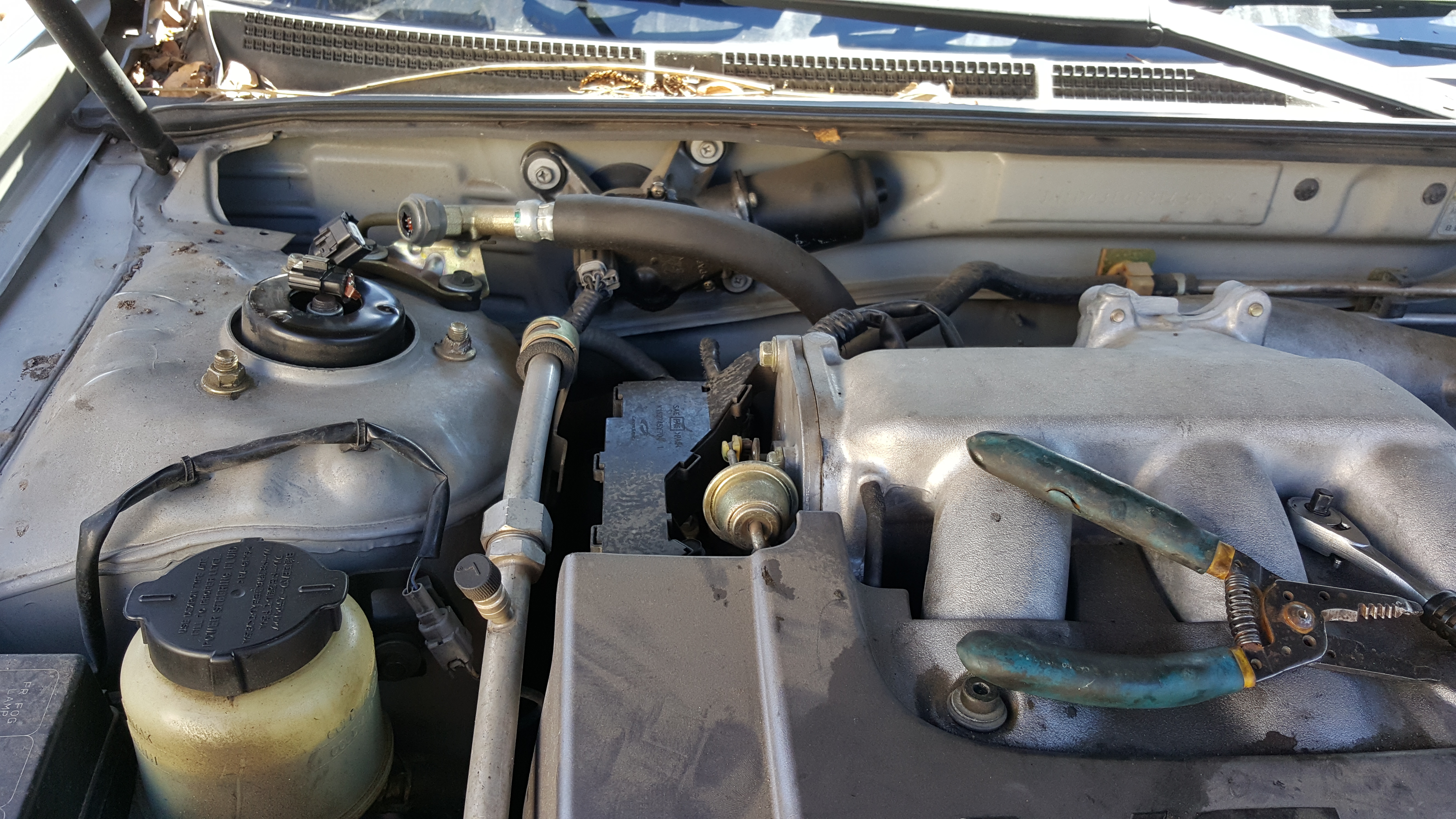

Hello
Quick question, I'm trying to replace a broken part in my car but I do not know what this part is called or where to get it for a good price.
Thank you
2003 nissan maxima GLE

Originally Posted by Foo2009
Hello
Thank you
Power steering pressure sensor; you can get it here https://www.rockauto.com/en/moreinfo...431954&jsn=414 .

I have a 2003 6 speed vq35 and it needs a full engine wiring harness Ive been searching all over and cant find one but I can find lots of 5 speed wiring harness is there any difference?
Massive difference, the 5MT will not work since it's from a previous generation ECU, so it will require a lot of modification, and probably wont run with your current 03 MT ECU.
Did you try here: http://www.car-part.com/
I've had luck in the past w/ full engine harnesses. BTW, why do you need a new one? That's unusual.

its funny you would ask that, be careful who helps you jump your car. I was having trouble with my alternator and it would drain my battery overnight, so a coworker of mine, coincidentally a mechanical technician helped me, when he pulled the positive jumper off, it got stuck on the cable so he ripped it up and my main power cable went with it, then he jammed it back down on the terminal and that was the last time it ran https://maxima.org/forums/images/smilies/mad.gif
