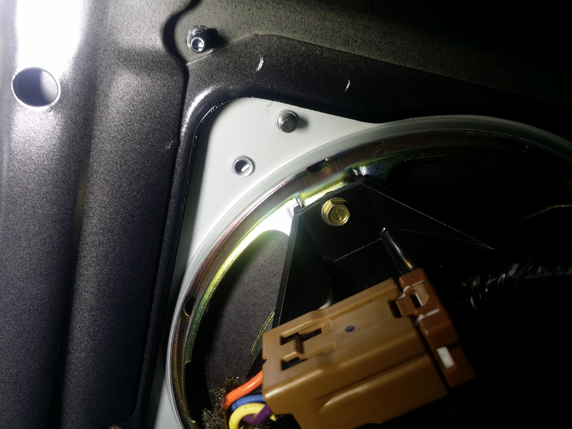

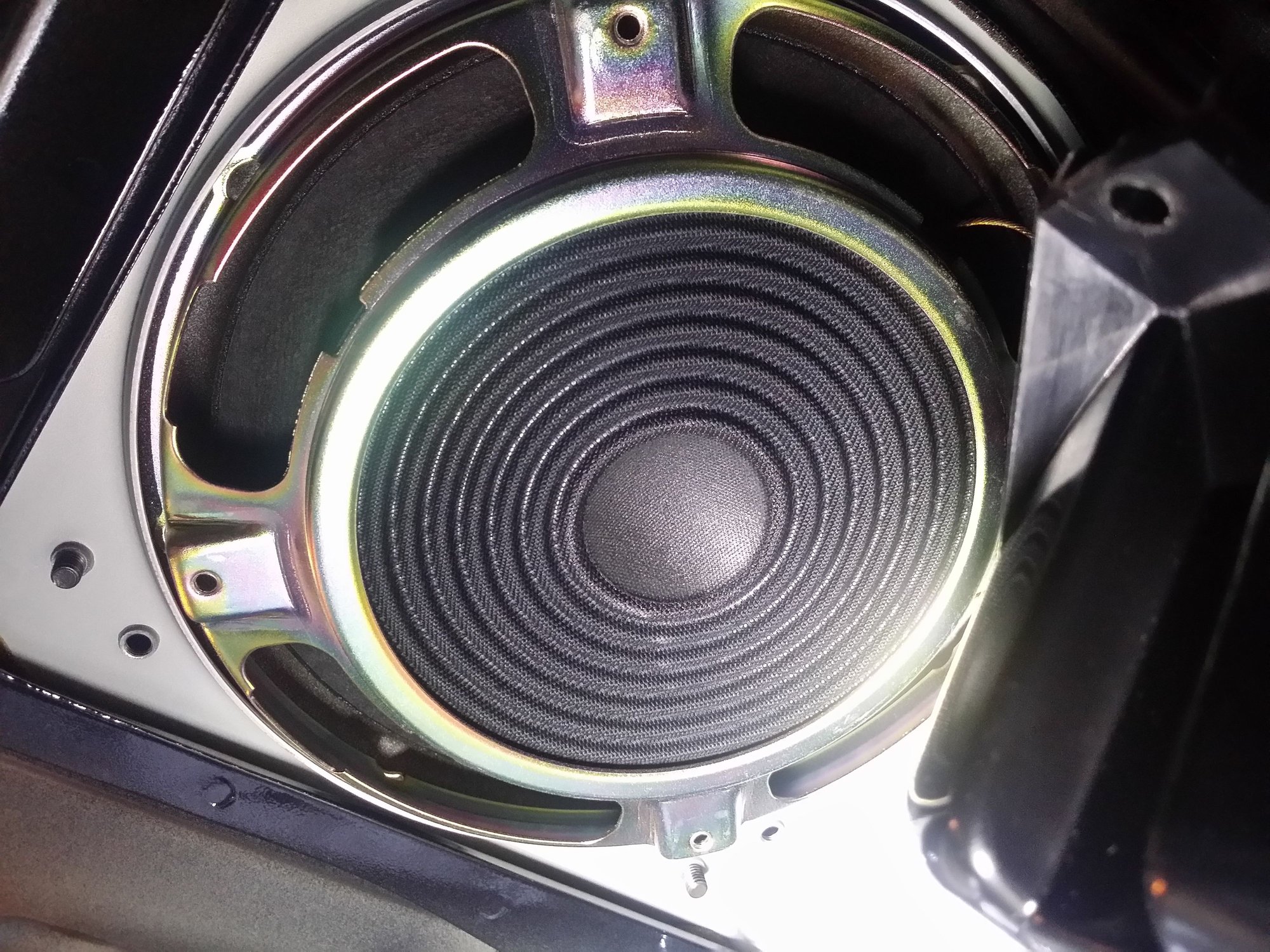

I know this is the Maxima section, but figured the I'd add to this instead of starting a new thread. I have a 04 I35, and I want to jump the circuit on the board instead of buying a new relay. Problem is, I can't tell exactly which 2 solder points I should be connecting. Can someone point them out for me? Also, I included some pictures of how everything looks on my car, since it seems there are slight variations. Figured it might be helpful for the next day.
Before I got started (the black box is what needs to be removed to access the silver metal box that houses the circuit board.
Anyone know what the white plastic covering is for? There are 2 on the underside of the rear shelf. Not important but I'm curious.
You'll need a 1/4 wrench to get at these screws. A ratchet wrench will work for the other 2 screws, but there's not enough space here with the brown connector there to use a ratchet wrench.
This is after the black box is removed.
