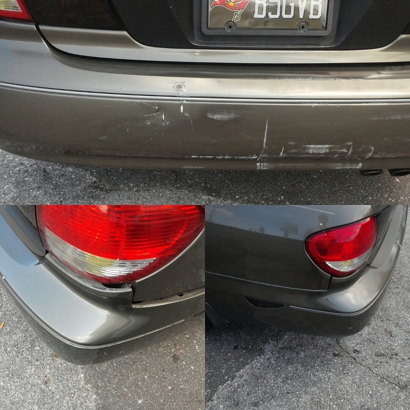

Hit and run my gf was driving she got the other cars license plate how much $ u guys think.
Size:  248.9 KB always something.

[QUOTE=mrjamaica98mx;9110080]Hit and run my gf was driving she got the other cars license plate how much $ u guys think.
$300 at maaco

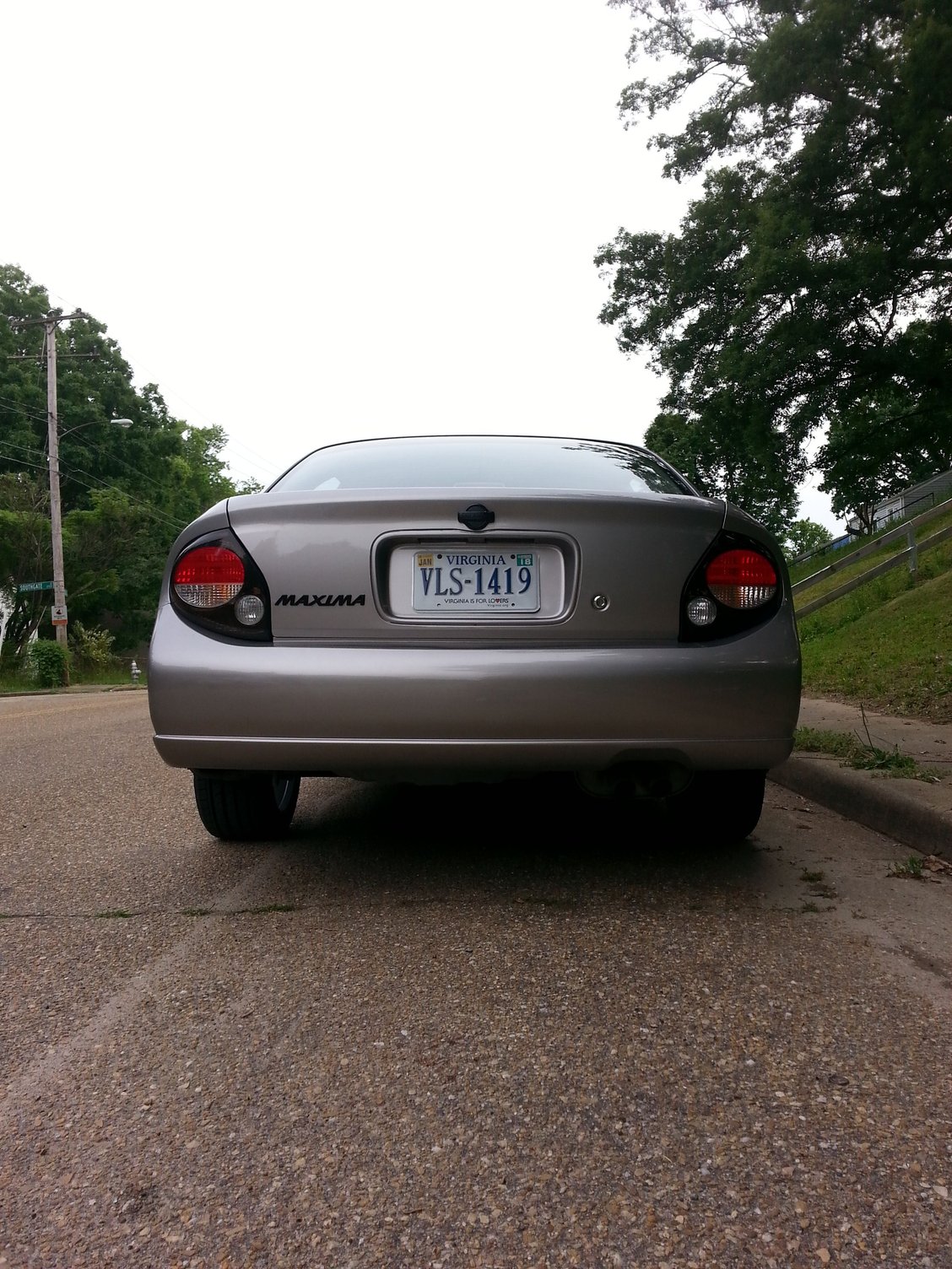

I swapped in my 01 SE "carbon" tail lights from my other maxi. Also painted the front grill black (not the Nissan Logo)
Should have the new tires mounted on my 18" 350z Touring V1's today.
I'll post some pics when I get them on!
