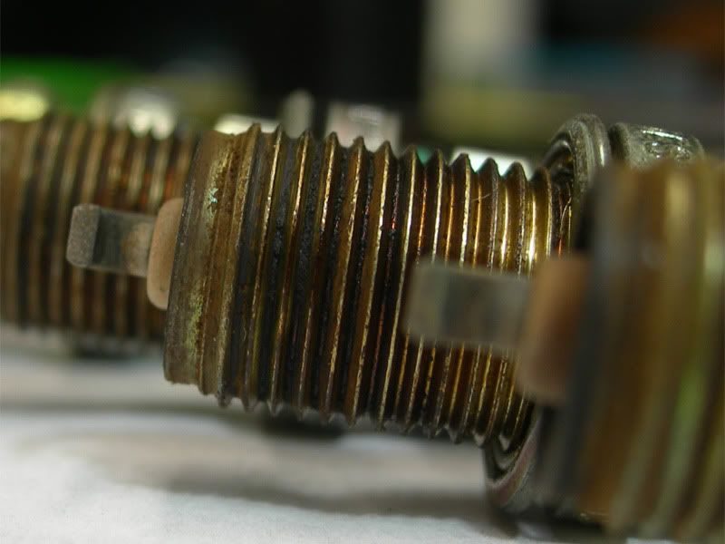

Here are the old spark plugs from my 1994 Maxima
Here you can see some combustion residue on the threads - this can cause plugs to stick, difficult to remove. Worst case - strip the hole..
Many people use anti-sieze on the threads of new plugs prior to installing them.
I do
